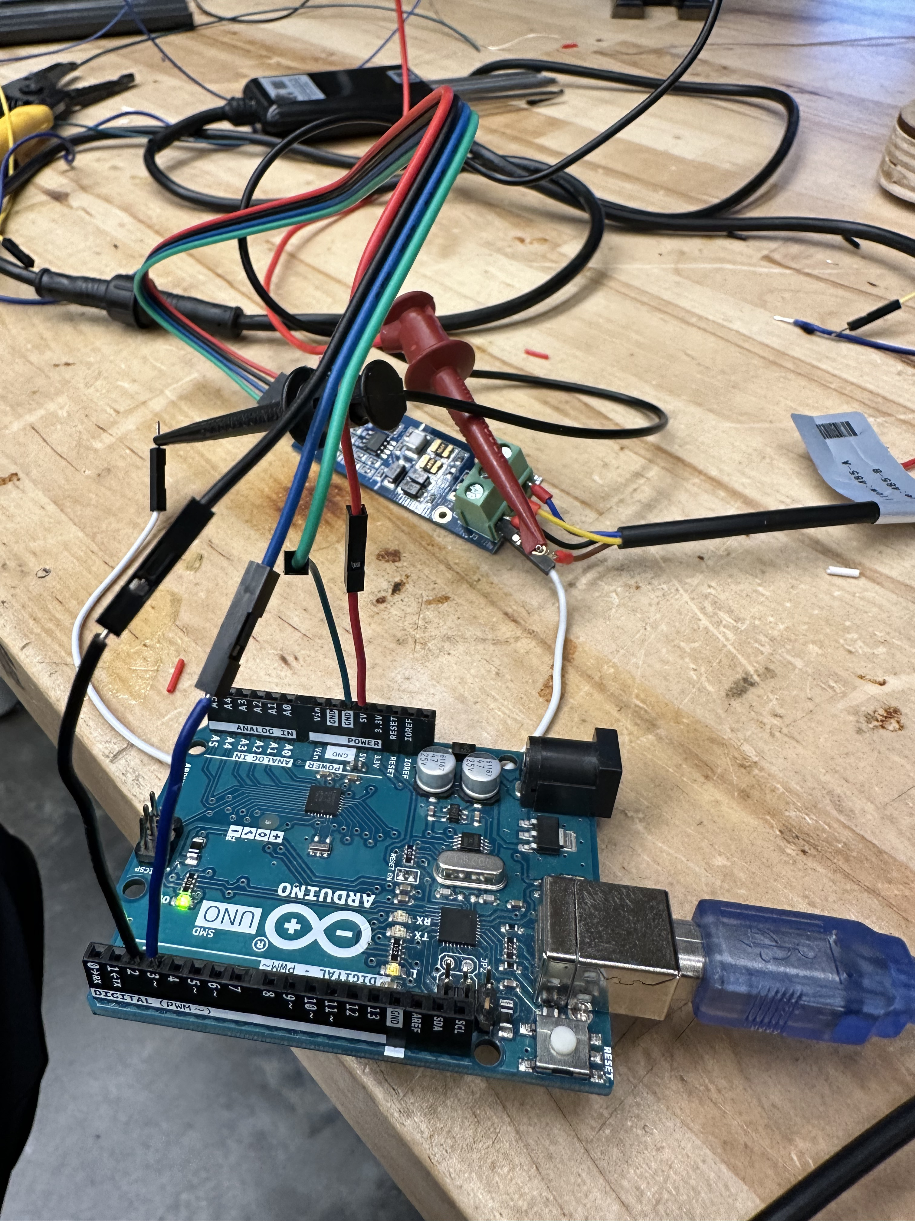

RS485 Over Soil Sensor, unable to receive any readings
I'm working on a university capstone project and am running into some issues getting rs485 up and running.
the soil sensor has power to ground connectivity and so do all the pins coming off of the TTL Conversion board. I checked this with a multimeter
Components I am using:
Arduino UNO
DSD TECH SH-U12 RS485 to TTL 5V Board with MAX13487 Chip
https://docs.qq.com/doc/DUGtXbVhXZG1JckJq?newPad=1&newPadType=clone this is the link to the information. From amazon reviews I've read that there are cases where the TX/RX pins are reversed/the A and B Pins are reversed for the RS485 Side of things but I've tried that to no avail https://www.amazon.com/DSD-TECH-SH-U12-MAX13487-Raspberry/dp/B07B667STP/
5 Pin NPK Soil Sensor datasheet:https://cdck-file-uploads-europe1.s3.dualstack.eu-west-1.amazonaws.com/arduino/original/4X/d/f/5/df5ca5c3b195421786e97743713e97298e3eb638.pdf
https://www.amazon.com/Comprehensive-Corrosion-Resistant-Temperature-Conductivity/dp/B08M5PHQZ7/
This isn't the exact data sheet but the register mapping seem consistent across different manufacturers.

On this code I get an empty output. I tried changing around the TX/RX cables and the board changes from flashing RX to TX but its only ever just that one flash it never sends anything back and changes to TX/RX after sending the message.
I am using a 12 volt power supply to power the soil sensor it accepts 12-24V
Any advice on how to troubleshoot this further would be much appreciated

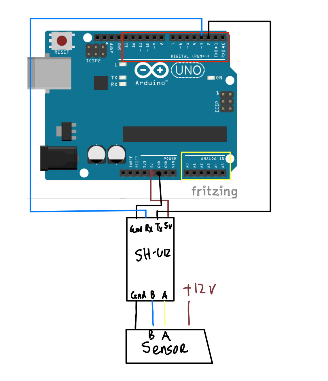

Please make and post schematics. Pen and paper surely works.
Thanks.
It looks okey.

Correct. Your sensor isn't responding at all. Your wiring schematic looks ok.

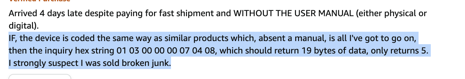

Ok I think it seems that 9600 was the better baud rate. I’m now getting a periodic sequence of:
1 83 2 C0 F1 this is inconsistent with the expected return value that should contain more bytes than what’s coming out. This sequence repeats and then eventually just starts returning only 1 after the program has been running for some tome.
From scouring multiple data sheets it seems that for the 4 pin soil sensor they all have the same register mapping and command structure, but their baud rate factory defaults appear to be different. I’m going to sit down and attempt to decode the value against the data sheet now but I’m unsure if this data will yield any useful information since the data sheet outlines a return of 13 bytes for the command. When I call a different command that reads more registers I end up seeing the same sequence of 1 83 2 C0 F1. Would this incomplete response frame have to do with the delay on my arduino causing dropped bytes or an incomplete frame or is this more likely to be due to the sensor?
That sequence is useful to know.
Firstly, now you are using 9600 baud, your sensor is responding.
Secondly, that sequence of bytes is a valid and complete modbus message. It decodes like this:
01 - the address of your sensor
83 - is the sensor reporting an error against function code 03
02 - is the error code
C0 - CRC16 LSB
F1 - CRC16 MSB
That would suggest that the user manual you have is not the one for your sensor.

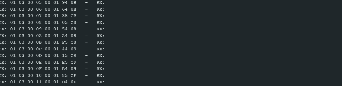

My ttl-rs485 only has tx,rx,gnd and 5v. Do i want to still keep the RE, DE pins? Or should i modify that logic.
You can leave the code as is. If your wiring connections are as per the diagram in post #3, then the code will run just fine without connecting anything to the pins designated for RE & DE.

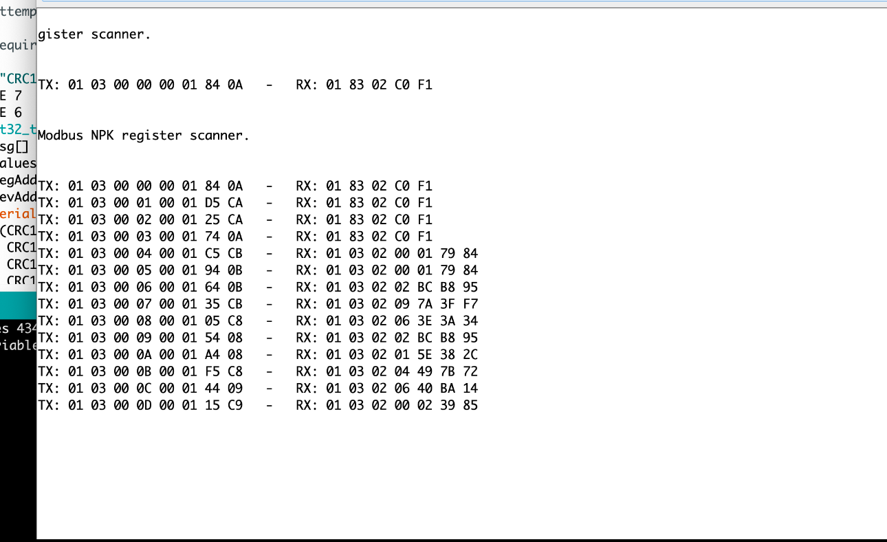

This is what it looks like upon running it. The data at the end looks more promising however the frames are only 7 bytes. Are these modbus frames non errors?
here is a more complete screenshot. These appear to be like more correct data frames however they are in conflict with various datasheets i've found online.
That looks promising. They are all correct modbus responses. You see 7 bytes because the request (TX message) is only asking for one register at a time.
Any RX frames that start 01 83 mean the sensor doesn't use the register in the TX message.
However, we're interested in the RX frames that start 01 03. Those ones mean the sensor supports that register address.
Register addresses $04 to $0E (14 dec) have got data as have register addresses $12 (18 Dec) to $15 (21 Dec).
I checked my spreadsheet for register mapping and I don't have an NPK sensor recorded that has a block of registers from $04 to $0E.
As a complete guess, register $0A may be temperature - that would decide to 35 degC. However, register $13 might be temperature too. That would decode to 20.1 degC.
I would ask the seller for the correct manual and if they can't provide it, return the sensor for a refund.
