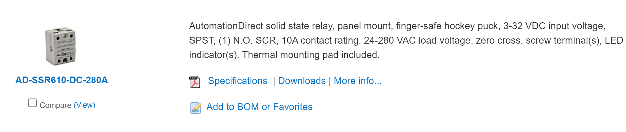

https://www.automationdirect.com/adc/shopping/catalog/relays_-z-_timers/solid_state_relays/ad-ssr610-dc-280a
this relay says "zero crossing". Can I simply run this from a pwm pin, or would I still have to get a separate zero-crossing detector?

On/off switching will not give you a stable heat output.
No, because unless it did zero crossing detection you would get massive interference; and if it did use zero crossing detection it would go in and out of synch with the mains frequency.
You should EITHER use a larger thermal mass and switch more slowly - 1 second only allows for 40 zero crossings;
OR
use a triac circuit for fully proportional control (over a limited range)
but if you use a triac circuit you will need to manage the isolation from the mains.
