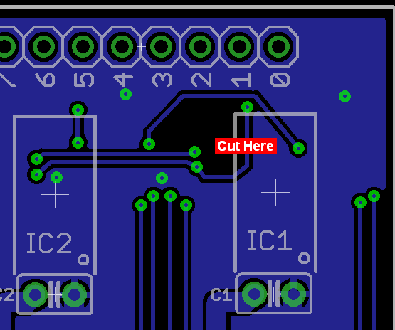

Hmmm... I was wondering why your code is setting pin 3 to an output and low. But now I'm looking at your schematic (don't know if it's the latest) and I see that pin 3 is hooked up to the reset lines of all of the chips.
Besides the SCL and SDA pins you are using, these I2C signals are also on pins 2 and 3. Once you initialize the wire library, I'm sure it's re-setting pin 3 to be the SCL signal, overriding your settings.
However, that means that the SCL line is being fed to the reset pins of your chips. Every I2C clock cycle is resetting those chips! I don't know why none of us saw this before now. :o
For a quick test, gently bend the pin 3 shield pin out of the way so it isn't making contact with the Yun, and use a jumper to temporarily hold that unconnected pin at 5V, and see if it works.
If that makes it work, then you will need to cut the trace going to shield pin 3, and jump it somewhere else, like to pin 4. (A hobby razor knife and a very thin piece of wire will come in handy here. I use solid core wire-wrap wire for such jumpers.)
Another issue is that you are setting pin 3 low. The reset pin is an active low signal, so by holding the line low you would be holding the chip in reset. I say "would be" because the pin will be redefined as I2C by Wire.begin(). But it's something to keep in mind when you move it to another pin: initially set the pin LOW to reset the chip, but then set it HIGH and keep it there to be able to use the chip.

Cut the trace leading to pin 3. Do it on the bottom of the board where it's less visible (see attached.) Using a hobby razor knife carefully cut a gap in the trace. Then, solder a fine jumper wire from one of the reset pins at the chip (or one of the vias in the chain if they don't have soldermask) and connect it to +5v, the shield reset pin, or another shield I/O pin. If possible to solder onto one of the vias, I would put the jumper on the bottom of the board, going from the desired shield I/O pin to the nearest via on that trace.
An example of a cut and jumped trace:
Note how the trace was cut through just above the right end of the black wire, and then a fine wire was soldered in to make the correct connection. Note how the wire is glued down to the board - this is a very good idea. Either cyanoacrilate super glue can be used, or blobs of hot melt glue.
This is not an unusual situation, it's quite common for there to be several cuts and jumps on a new board design. If this is the only issue that crops up, you're doing great!

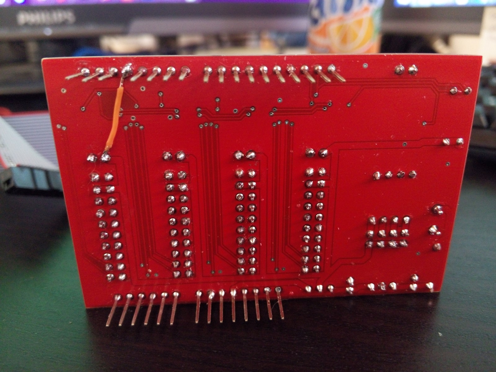

Pin 9 could be a good candidate for replace pin 3, right? I would avoid to make a shield that is incompatible with ethernet shield and gsm shield, that i think they are the most used.
Is it a bad idea if i cut pin out of pin 3 and attach it to pin 9?
I think there is too way to arrive at reset pin for make it with a bottom wire..
i usually i dont like external wire on pcb but it seem the only solution :confused:

I mean cut pin 3 and solder a wire between pin 3 and pin 9 on bottom of shield. :slight_smile:
You could do that. But it would be a cleaner mod if you could solder a jumper from pin 9 to the nearest via on that line. If you can, then cut the trace where I indicated. It all comes down to whether the vias have solder mask over them. If not, that's a cleaner way to go, as it leaves the circuit in place through pin 3 in case you add a shield that uses those pins 2 and 3 for I2C.
here we are! :grin:
I tried to solder pin 9 with nearest via on pin 3 line but they are too small for solder a wire that can be stay there good, so easiest solution was cut pin 3 and connect a small wire to +5v. Nearest via is +5v bus that arrive at cap on chip 0.
It is not so beautiful, but it works! :stuck_out_tongue_closed_eyes:

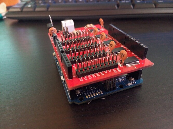

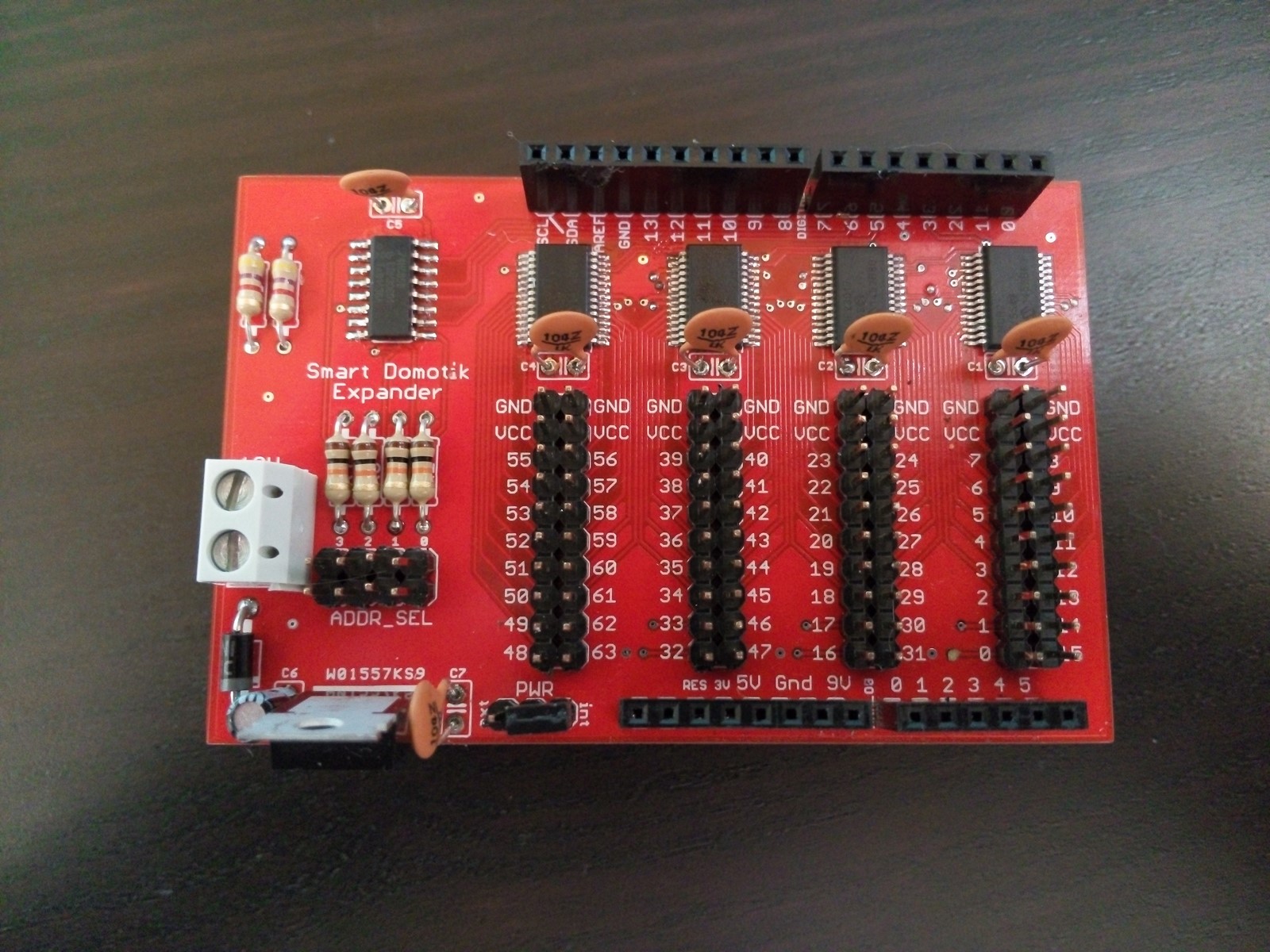

I attached some pics of shield completed, i don't like that type of caps, maybe I'll change in next builds.
This shield looks like a little town :grinning:
Looks nice! 8) The repair should work well, and looks nicely done.
Yes, those caps are quite large. There's a 1K marking on them, are they rated for 1000 Volts? :o If so, you don't need anywhere near that high of a voltage rating, anything over 15 volts will be more than enough, and they will be physically smaller and fit better. (Of course, the cap on the input of the voltage regulator should be rated higher, the 50V rating on the cap you used looks perfect.)
I notice the markings on the shield connectors of your Yun look like stickers. Interesting, the markings on mine are printed directly on the headers. Obviously, ours were built in different batches.
