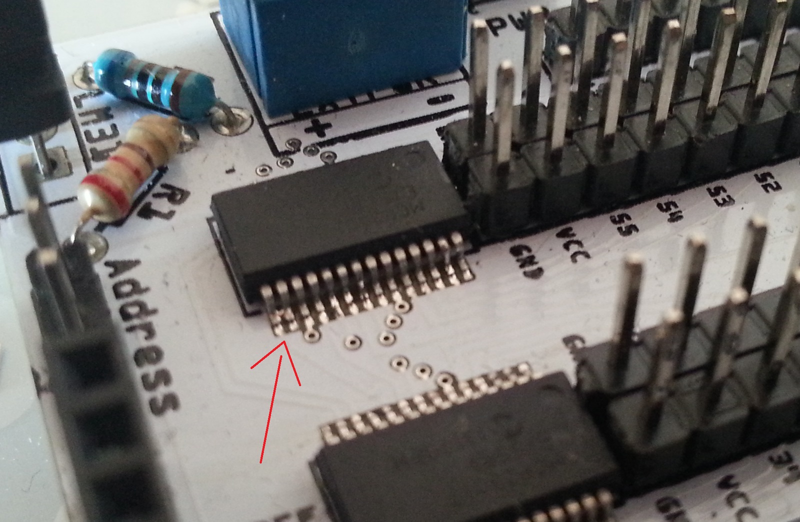

Ok maybe i found the problem.
If you look at the attached picture and zooming here:
You can see that on chip3 pin A0 and A1 are connected to pin VSS (GND) of chip2 instead of VDD (5V) !!
So the adress of chip3 is 000 instead of 011 :frowning:
Wrong PCB.. Now i need to find another solution :frowning:
Looking where your arrow is pointing, there appears to be a solder bridge between the first two pins in that corner. A quick touch with a clean soldering iron (no solder on the tip) should clean that up. It could make a world of difference.
If it really is a board layout issue, you could try repairing it, but that is a very difficult proposition: unsolder and lift the wrong pin from the board, or cut the trace leading to it if it's visible, then attach a fine jumper wire from the pin to the right signal. But that is a drastic step, I would be in touch with the board builder first. But if you get no satisfaction from him, then it would be easier than designing a new board.

I thought that the problem was the bridge, but after follow the pcb i saw that is right that bridge exists, because address of chip3 should be X11 where X is the dynamic pin that is assigned from address jumper.
The problem instead is that these 2 pins are connected to GND instead of VCC, so result address is X00, that is the same of chip0.
Layout is very similar of the kickstarter page... :roll_eyes:

If you're going to throw out the board, you might as well try to fix it by lifting the two pins and connecting them to Vcc. I would've suggested trying to cut the traces rather than lift the pins, but based on the rest of the layout, the ground trace probably continues on under the chip and you can't cut the trace there. So unsoldering them and lifting them is probably the way to go. You just have to be careful not to overheat the pad and lift the pad from the board, as that will could break any path going under the chip (but that could be fixed with another jumper wire.)
Fixing the board would be a lot easier than building a new one. But then, of course, you will still have the bad power and analog trace routing and lack of bypass capacitors. While more expensive and more work, you're bound to end up with a better board.
I just took a closer look at the board, and I think I might have figured out what happened. If you follow the traces on the layout picture on the KickStarter page, the A0 and A1 of that chip are tied together, then go to pin 10 of chip 2, which then goes to Vcc on the header. That looks correct. But if you look at the pinout of the chip, pin 10 is ground, not Vcc! On that layout he has all of the power and ground pins for those chips reversed!
He must have caught that problem, and fixed the swapped signals, but he didn't catch the trace running to those address pins. Looking at the photo of the finished board under the udpates tab, it's clear that those address pins are still connected to pin 10 of the second chip. Therefore, they have the wrong polarity on them. How unfortunate.

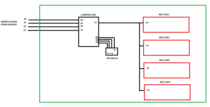

Thinking on your suggestions, I've got another idea for simplify components.
If i understand, I should send 16 selects to every single board, and define every board what is, but if i have to build a dynamic system where every board can be added without user modifications, maybe this could be simpler:
  • I send 4 address lines to all boards
  • I put a 4 way dip switch on every board for define address
  • I add a "chip" that compare if 4 address lines is equal to 4 way dip switch value and set A2 of MCP to low if it's ok
so for selected board I can use MCP as 000 - 011, and for disabled boards they have 1xx.
With this i have to send only 4 pins to every board (+ i2c) that can be put in sandwitch, for a total of 16 board.
What do you think? What "chip" i can use to compare if 4 address is equal to dip switch value of the board? Something like this? http://www.farnell.com/datasheets/1870913.pdf
Actually, what I was suggesting is very close to what you just drew. There would be one decoder chip on each board, so only the four address lines are needed between boards. The downside to my scheme is needing a 2x16 header to select the address, and the danger of misplacing the jumper and generating an invalid address.
Your idea should work, take less room, less connections, and be harder to misconfigure. The big difference is that the address select line is now active high instead of active low. If it were being used as an SPI chip select, it would need to be inverted. But if you are feeding it into A2, that won't be necessary, you just have to address the chips slightly differently: 0xx is disabled, and valid addresses are 100, 101, 110, and 111.
I had briefly considered your scheme, but dismissed it because I didn't spend enough time looking for a suitable chip. I was only searching for an equality comparator, and the only one I found compared 8 bits. I thought that was physically too big of a chip and too many wasted inputs. I forgot about that magnitude comparator, which is a very useful chip. (I made a traffic light controller with one over 30 years ago, before I had access to microprocessors: a 555 slowly incremented a 4 bit counter, which was fed into the A side of that chip. The B side was hard-wired to 0111. Then the green light was controlled by the less than output, yellow by equals, and red by greater than. Green would be on for 3 counts, yellow for 1, and red for 4 counts. The opposite direction was wired with opposite sense, off of the same counter. It worked great and only needed a few chips.)
I think your drawing is a great solution! You just have to use A2 as high for the active board.
Ok, so if i'm not so far from the final solution, this is what i quickly drawn until now. What do you think? :blush:

leen15:
Looks pretty good. :sunglasses: I do have a few constructive comments:
  • Add bypass capacitors to each chip.
  • It looks like you are powering the board and everything connected to the I/O headers from the 5V output of the Yun. I wouldn't do that, it's going to be too much of a load, especially if you have a stack of these boards. Put a separate 5V connector on this board and don't connect to the Yun's 5V pin. As a compromise you can power just the chips from the on-board 5V, and have a separate connector for the I/O header power. However, be aware that the Yun's 5V output is really only about 4.5V because there is a polarity protection diode in series with that pin.
  • The signals between the DIP switch and the B inputs of the address comparator will be floating when a switch is open, which is not good. Normally, one would use pullup resistors on those lines, and the common side of the DIP switch would go to ground. If you really want the common side to go to 5V as you drew it, then you would need pulldown resistors.
  • I'm concerned about J2: it looks like you are grounding out the 3.3V and IOREF lines (as well as the unconnected pin.) The Yun will NOT be happy about that!
  • You have the I2C signals connected to A4 and A5. That works for a '328P based Arduino, but the Yun with its '32U4 processor puts the I2C signals on the larger digital I/O connector, after AREF. (You have them labeled on your board layout.) You may want to flop your layout vertically so that the I2C lines don't have to run as far -- put the chips by the upper digital side and the connectors below them.
And finally, a discussion about the physical form factor. You're using a standard shield layout. But if you look at the vertical profile of a Yun, you'll see that the Ethernet and USB connectors extend higher than the connectors on a more standard Arduino. This may cause problems plugging in a shield unless you use a connector with extra long pins. Even so, using a through hole DIP switch will put one row of the pins that extend through the board directly on top of the USB connector, requiring even longer stacking connector pins to prevent a short. I would avoid putting anything on the bottom of the board (or extending through the board) in the vicinity of the USB or Ethernet connectors (or in the vicinity of the Yun's 6-pin ICSP connector.)
As an alternative to using extra long connectors, I see that the left side of your shield is mostly unused. It will be tight, but if it were cut off right next to the SCL pin, you may be able to fit the board next to the Ethernet and USB connectors, and use regular stackable headers. In that case, your address decoder and DIP switch would need to move, and space is becoming an issue. Maybe put the decoder on the bottom of the board, and use a low profile surface mount DIP switch? Or perhaps make an irregular shaped board where the areas for the Ethernet and USB connector are cut away, and the address decoder is on a tab that extends between the connectors?
PS: If i use watchdog in code, should reset also MCP chips if they are connected to arduino reset pin?
Looking at section 8.0.6 of the '32U4 datasheet, it looks like the watchdog reset pulse is only internal to the chip, it does not cause a pulse on the external reset pin. That section of the datasheet shows a timing diagram, and the RESET line doesn't change during the displayed sequence. Some other processors I've used do generate an external pulse, but it looks like this one doesn't.
So it doesn't look like you can count on the watchdog to reset your port expander chips. The safest bet might be be to connect the reset pins to a digital I/O pin. That way, at the beginning of setup() you can manually pulse the pin to put things in a known state. It may also be helpful to be able to manually reset them if you should run into an I2C bus lockup.
