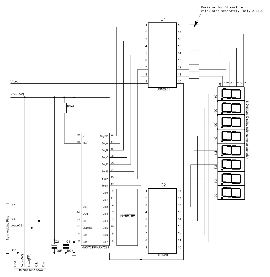

I had a look at the datasheet and it looks like there are 4 Leds in series for each segment. The forward voltage of ~2.0V given in the table on page 2 seems to be the on for a single led only.
So that would explain
A) why the segments do not light up : They need an inputvoltage of >8V because there are 4 leds (4*2.0V)
B) why the DP lights up. There are only 2 Leds on this one so it needs only 2.2.0V=4V on the input.
To test this use your 330ohm resistor in series with a single segment input and apply 9V from a battery. The segments should now light up with the higher input voltage.
The bad news is : you can't use the 7219 to drive your 7-Segment displays, because it works only with 5V power-supplies.

Well, I guess my idea didn't work. I wish I had an easy way to make a schematic on my computer. It went something like this:
7219 Segment Output (source) > Allegro 2982 > LED Anode
7219 Digit Output (sink) > ULN2803 > LED Common Cathode.
I was able to get things to light with various permutations, but then it started getting weird, I ended up with all the segments on, just pulsing between high and low brightness (when the software was attempting to light a 0 and 1 alternating at one second intervals)
I was able to get flashing DPs through the Allegro when the CC was sunk directly to ground, but I think I burned them out. I also tried transistors, PNP and NPN in every conceivable configuration - still nothing. I guess I can try the direct method, however that would mean I would need two arduinos talking to each other for my clock project... which would suck. Any luck on your end?
I wish I had an easy way to make a schematic on my computer...
I've been playing with Eagle a lot lately, CADSoft Finanzportal - CADSoft Finanzportal , it's pretty nice for free, has some quirks, but a lot of PCB makers can use the eagle files. This is just a test circuit for a jumbo LED display driven by 10 arduino pins, I have no idea if it works, but it was done with eagle. The LEDs are Red @ about 1.85V apiece.
I would would have done it be exactly like this. But you did use 8 resistors on the Allegro2982 outputs for limiting the current through the Leds?
What was the supply-voltage for powering the Leds?
Just thinking : I'm not sure what the happens on the 7219 Digit-outputs (2803-driver) when a row is selected :-?
If the Digit-output is driven LOW for the selected digit, we would need an Inverter for the signals, because the 2803 inverts the signal again.
Say, if digit 2 is selected the state at the 7219 would be HHHHHLHH.
But that would make the ULN2803 switch on the transistors on all but the digit2 column.
With an inverter we would have LLLLLHLL on the 2803 inputs and only the current through digit 2 can pass through.

Here is (sort of) a schematic how I think it should work.
Download from here: http://www.wayoda.org/share/pictures/MAX72XX-HighLoads.jpg
I used a single resistor on the cathode end. I figured 6 resistors for the cathodes is better than 48 for the anode segments.
You won't need 48 Resistors, just 8 : 7 for the segments that make up the number and one for the decimal-point which also needs to be calaculated seperately because there are only 2 Led's in series for the DP.
Supply voltage was 18V (two 9V in series) although I tried 9V and 12V as well.
12V should work fine :
The UND2981 will take away roughly 1.6V from this and the uln2803 another 0.9V the you have the segments with 8V (check datasheet again for this) which leads to a resistor of
(12v-1.6V-8V-0.9V)/0.02A=75 Ohm.
Before you burn out you digits I would go for a higher value for testing (330Ohm).
Also note that the resistor on the DP is calulated as:
(12v-1.6V-4V-0.9V)/0.02A=275 Ohm. (Since there are only 2 Leds in series on the DP)
I have a feeling you are correct in that the 7219 pulls the digit pins low to sink the current (as the digit pins are meant to connect to common cathodes). Please tell me if I'm not making sense, I'm still learning the terminology :stuck_out_tongue:
Here comes the Part in the schematic called "Inverter". I didn't give a part-number any TTL-inverter should do (74LS06 should do for your purpose since you only need 6 digits)
Eberhard

Still no luck :confused: tried it exactly like the schematic (minus the capacitors - didn't have them). Finally got it to source and sink, but all I got was a jumbled mess, no matter what digit I wrote to the display.
Should I give up and try one of those allegro high power shift registers with a common anode display?
I guess you had no luck turning single segments on and off?
My UDN2981 will arrive either today or tomorrow, then I will try to control an array of Leds from an ATMega that acts as an I2C-device (similar to this : BlinkM — ThingM)
The Allegro shift registers are quite expensive (here in Germany) and I'm not sure how much Arduino processing power is demanded by this solution. I will post a schematic for my prototype tomorrow...
Eberhard
Success! I took the plunge and bought six common anode displays off ebay, and six Allegro 6278 sink drivers from DigiKey ($1.55 apiece). Took me some fiddling to get ShiftOut to work, but I was able to get it working. He's my code - I stole it from an example so it looks a little weird, but it counts from 0 to 9 on one display.

hey everyone,
I know this thread is almost a year old now but I am having some problems figuring out exactly what to do. I have gone through every post and followed every link in all of the posts and I can't quite seem to put all of the pieces together.
Here is where I am at. I have the 6inch 7 segment displays from sparkfun, I have the Allegro 6278 sink drivers and a 12v power supply.
I can get all of the segments to light up by simply running them through my power supply. But I am still not sure how to hook them up to Arduino to make them display the numbers. Any help would be greatly appreciated, even a pretty picture would be fantastic. :slight_smile:
Thanks for the help.
So after some experimenting and more digging I as able to get this working.
Here is a diagram of how I hooked it up. The chip in the middle is an Allegro 6278EAT, the resistor is 15k and I used a 12v/1700mA power supply to power the digit only.
It also uses the Arduino sketch in the above reply.
I hope this helps someone out.
Cheers
