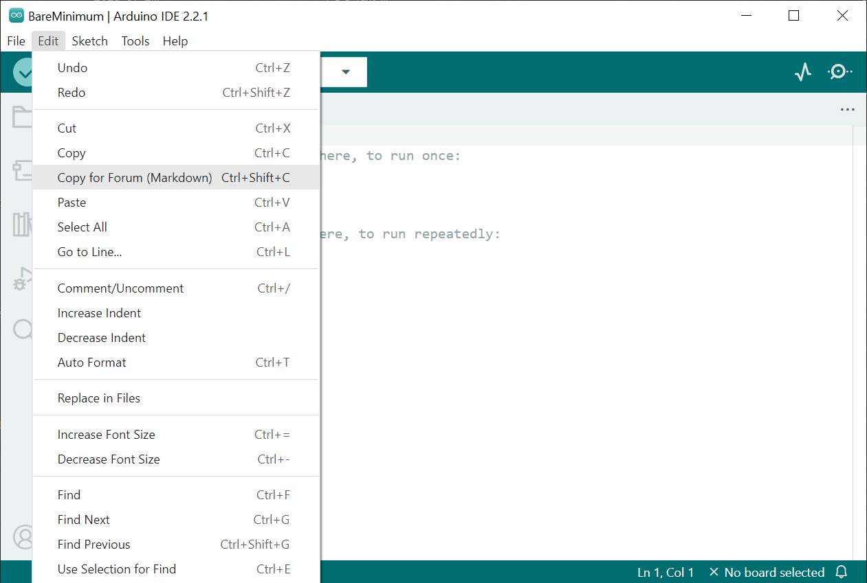

Photo screen is not so good, because can't copy to my computer to test.
The IDE has a button to help: Edit > Copy for Forum (Markdown)
