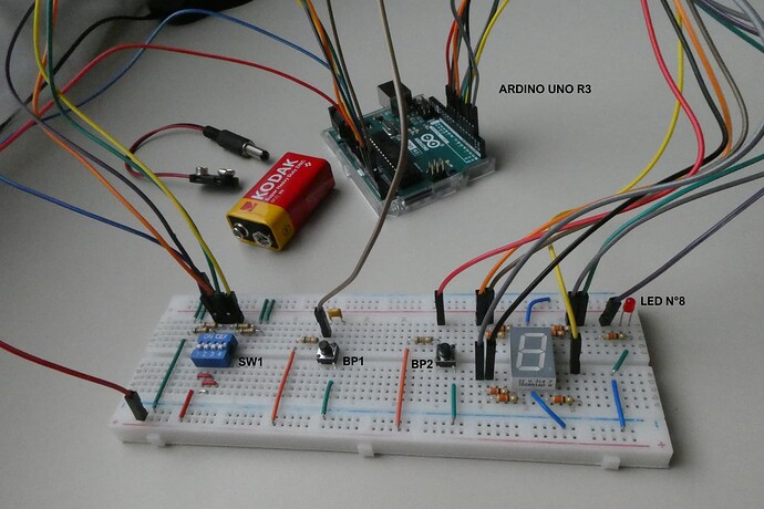

Hello, toddnz,
I think you read the previous Post #65
I just received the cathode display this morning.
I drew the organizational and put it here.

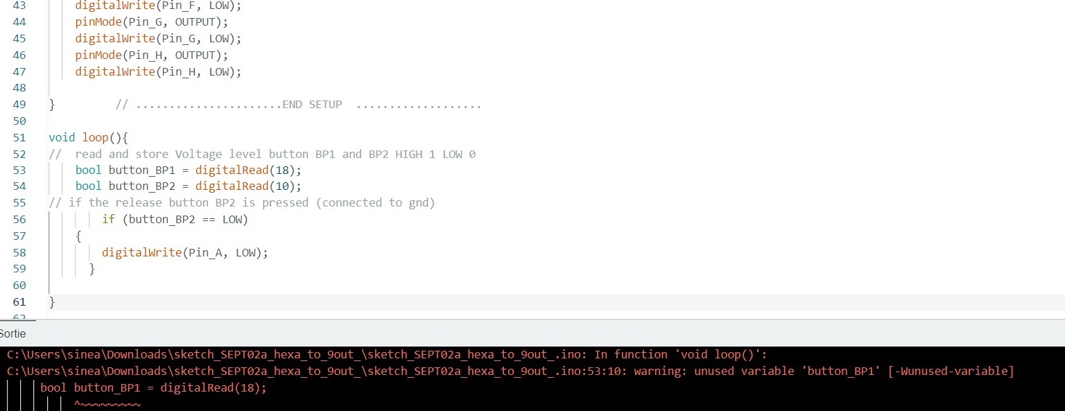

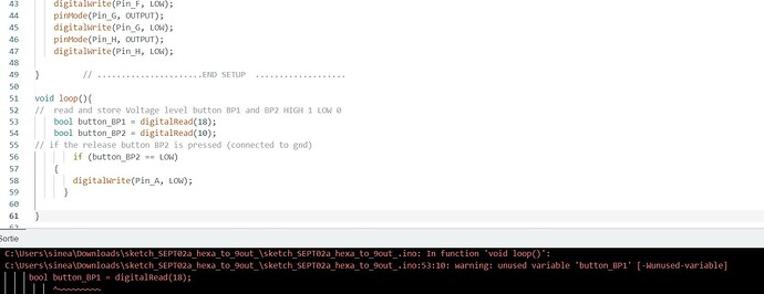

Hello toddnz
The lines in IDE " bool button_BP2 = digitalRead (10) " , bool button_BP1 too
indicate an error
button_BP2 and button_BP1 are not in the list.
Best regards
Jack
I'm not sure, could you please copy and paste the exact error?
Please also post your full code, so I can see where the error comes from.
Ok toddnz,
I think what it's because BP1 is not developped.
for BP1 errors,
Hello toddnz,
You can see my error ....... C is not c

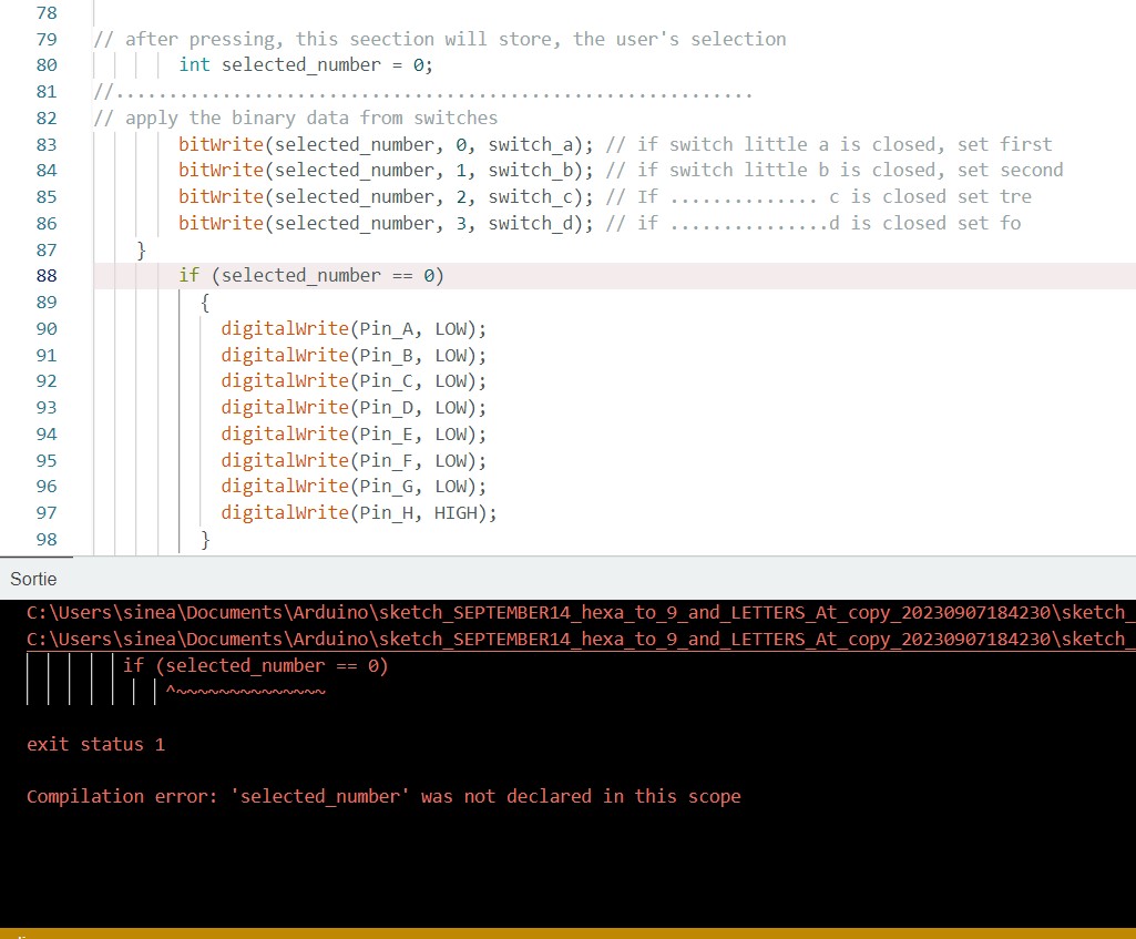

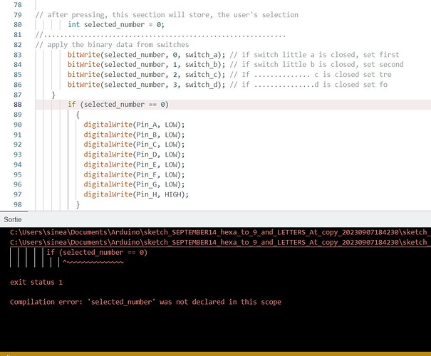

I have worked on the sketch, there is a problem wiith hexa letters A at F to memorizate it.
See the // after number 9.
Ihope yours informations, Thanks ;
here the sketch compiled ok

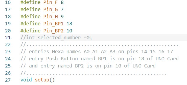

#define Pin_BP1 18
#define Pin_BP2 10
int selected_number =0;
// entries Hexa names A0 A1 A2 A3 on pins 14 15 16 17
// entry Push-Button named BP1 is on pin 18
// and entry named BP2 is on pin 10 of UNO
           // this lines run once

    bool button_BP1 = digitalRead(18);
    bool button_BP2 = digitalRead(10);
    //bool button_BP1 = digitalRead(18);
// if the release button BP2 is pressed (connected to gnd)
        if (button_BP2 == LOW)
        digitalWrite(Pin_A, LOW);
// if the valid selection BP1 is pressed level is LOW
        else if (button_BP1 == LOW)

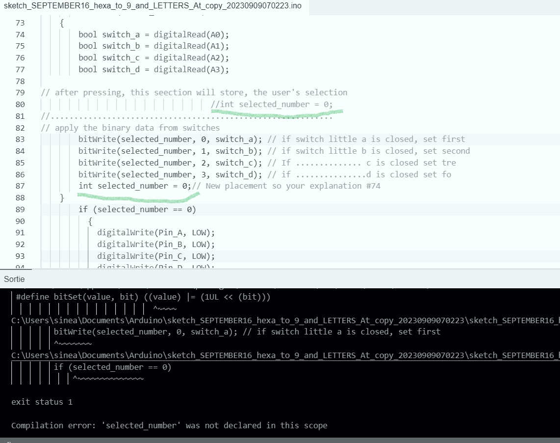

        bool switch_a = digitalRead(A0);
        bool switch_b = digitalRead(A1);
        bool switch_c = digitalRead(A2);
        bool switch_d = digitalRead(A3);
// after pressing, this seection will store, the user's selection
        int selected_number = 0;
        //int selected_letter = 0;
// apply the binary data from switches
        bitWrite(selected_number, 0, switch_a); // if switch little a is closed, set first
        bitWrite(selected_number, 1, switch_b); // if switch little b is closed, set second
        bitWrite(selected_number, 2, switch_c); // If .............. c is closed set tre
        bitWrite(selected_number, 3, switch_d); // if ...............d is closed set fo
        if (selected_number == 0)

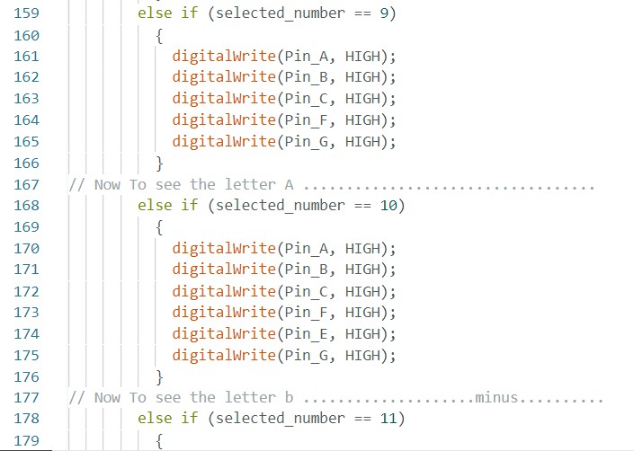

// Now To see the letter A ......................................
        else if (selected_number == A7) // .............WHY A7 ? ......

        else if (selected_number == B0) // ..............WHY BO  ?  .........

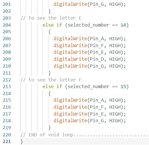

I am interested to understand, why did you try A7 and BO?
Ah you want to type the numbers after 9? Well, after 9 is 10, and then 11. If you change A7 and B0 into 10 and 11, I think it would work.
There is also another way: if you want to type in hex, you can start with "0x".
0x9 is 9,   0xA is 10,  0xB is 11, etc.
IDE screenshot showing "zero x" hex prefix

I try A7 in first and a second time for b minus B0, because the compilation give errors and suggested it to me.
I wrote it , A7 in first, and it removed the first error line;

On I D E , I complete the sketch for A to F with 10 at 15.
released A7 and B0,
and compilation result is OK with int selected_number=0; no delete (for this time).
I am study "int selected_number=0; now.
If I remove the line " int selected_number=0; under line #define Pin_BP2 10 , the compilation indicates this

Hello toddnz
I try to understand... But I have difficulties.
AA_after_Define
and........................................
Where is the error ?
to be continued,
Best regards ...........................Jack.
Sorry, I know it's a lot of writing.
Line #21: you have deleted. This is correct.
Line #80: you have deleted. This is not correct. You should keep line 80.
Line #87: you have added. This is not correct. It should be at line 80 only.
Line #89, #90, etc: All this code (about LED output) should move to Line #87, before the "}"
Explanation
Line #80:
Because you create selected_number between the { } of line #73 and #88, it only exists between #73 and #88.
At line #89 and below, selected_number is invisible.
'selected_number' was not declared in this scope
Means something like "selected_number was invisible here"
Line #89 and below
These lines are outside the { } of line #73 and #88. This means that #89 and below will run repeatedly, non-stop, really fast.
Lines #89 and below (changing LED output) should only happen when BP1 is pressed. To achieve this, lines #89 and below need to be before the } at line #88.
Hello toddnz,
I worked this Week-end to assembly all the parts and wires, so the schematic #27
you can see my picture here.
