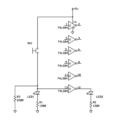

I am using it to modify a GRBL Shield, in order to manually Disable/enable the steppers one at a time. The inverse logic is to enable the stepper driver (LOW) while turning on an LED (HIGH) and vice versa.
The working circut:
So you have taken no of the advice given here. Why do you bother asking a question if you are going to ignore the answer?
No resistors in the LEDs.
And a pull down resistor where one is not needed if you wire the switch correctly and use one of the five unused inverters.

This might be clearer as to what you need, the two 150R or you can try 220R resistor in each of the LED circuits to limit the LED current.
One of the rules of TTL is never connect an input to Vcc directly, always use a series resistor.
This is because the inputs will fry at just over 5V, which is far too close to Vcc for safety.

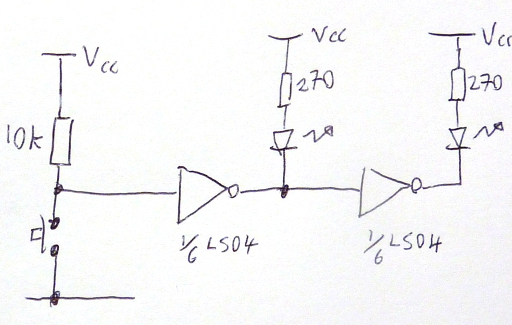

However as we are talking TTL, specifically LS TTL:
Inputs that are not from another gate should either connect to ground or to a ~10k resistor to Vcc.
Typically a switch would be wired to ground with a 10k pull-up resistor to meet this constraint.
LS TTL can only sink useful amounts of current, so LEDs/resistors are wired between an output
and Vcc, not between the output and ground....

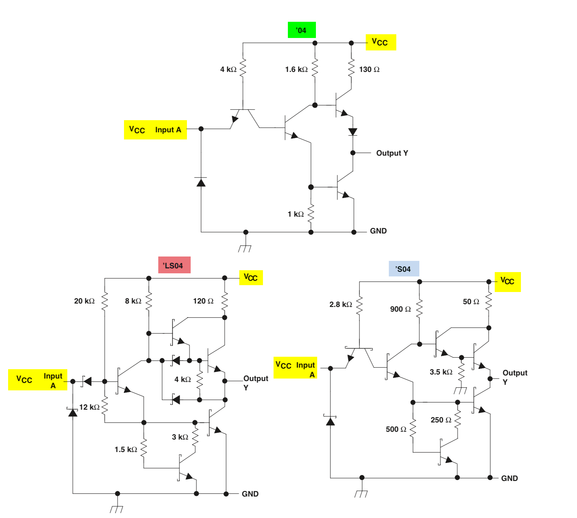

Over the years I.C. manufactures recommended to not connect TTL inputs to 5.5 volts (VCC).
From a huge amount of field experience, I have observed that old TTL equipment designers did not adhere to this advice.
I have never (never) come across I.C. damage from tying inputs to VCC.
In fact, the LS family inputs have a Schottky diode on the input which precludes any problem of reverse bias damage.
Refer to the attached equivalent circuit of the TTL family.
It appears VCC on the input cannot reverse bias/damage an input as the gate has VCC as its power supply.
Although in my old designs, I tie (tied) unused inputs to a unused output, tying them to VCC can be done as well.
Case in point, as I have mentioned equipment manufactures 'have done this' and (in my experience) 'gotten away' with doing so.
