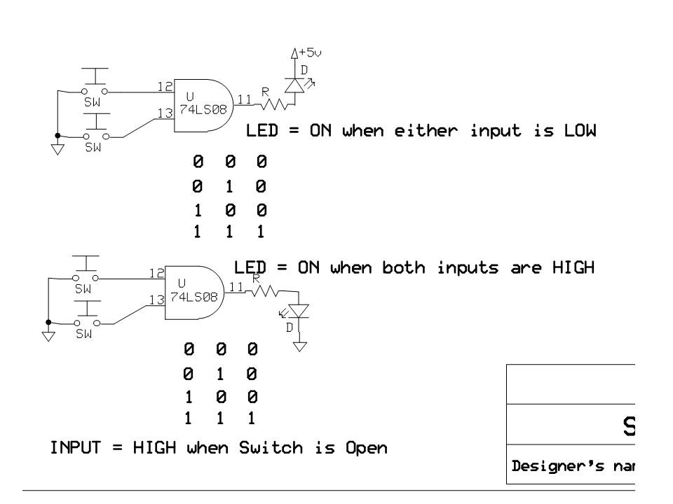

But during the testing phase I’ve encountered some problems. Wires are going from ground to a 4 dip-switch. From switch 1 to input 1, switch 2 to input 2(HD74LS08P = AND-gate) The output is connected to a led.
The table I’m getting is the same as a nand gate?! So when the switches are off the led is on.
What am I missing?
So when the switches are "on" you have logic-low and when the switches are off you have "logic high".
With 74 series chips an open is high. But it's still standard-practice to use pull-up resistors.

The OP never applied logic HIGHs to the inputs of the AND gate.

The OP is applying LOGIC LOWs NOT logic HIGHs.
There are no floating inputs
(The inputs are connected to GND via the switches)
The OP asked "What am I doing wrong", to which the answer is
"Your dip switch is connected to GND instead of 5V."

I don't see how any of you can have confidence in what is going on over in OP land. We can only assume the OP has any of this connected properly. And when he/she says, "output is connected to a led", connected how?
To the OP [Original Poster -- i.e. "PepijnK"]: We need a schematic of your set up, or at least a decent photo that makes it possible to see what you're doing.

How is the LED connected? Anode to output, cathode to Gnd (with current limit resistor)?
Cathode to output, anode to +5 (with current limit resistor)?
The OP said the gate works but as a NAND gate
(obviously since it's wired backwards, so the led operation is not an issue.
So how it is wired?

No, 74LS series require 10k pullups on any high input, and inputs should not be wired to
5V directly. Low inputs can be strapped to 0V.

FYI 2: The LED in the first example is backwards.
