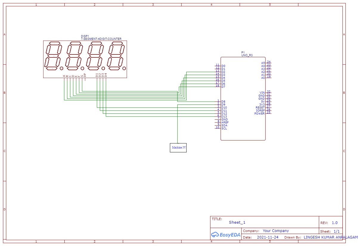

hi everyone, i developed a programmed where the count up will start when the machine runs..with the same arduino, i have to make a countup for downtime as well when the machine stops..im so confused on how to code this...i have done for the runtime part, can anyone help me how to code for both runtime and downtime using the same arduino?
#include <TimerOne.h>
//the pins of 4-digit 7-segment display attach to pin2-13 respectively
int a = 2;
int b = 3;
int c = 4;
int d = 5;
int e = 6;
int f = 7;
int g = 8;
int machine = 9;

  pinMode(machine, INPUT);
  Timer1.initialize(100000); // set a timer of length 100000 microseconds (or 0.1 sec - or 10Hz => the led will blink 5 times, 5 cycles of on-and-off, per second)
  Timer1.attachInterrupt( add ); // attach the service routine here
  int digit_value_1;
  int digit_value_2;
  int digit_value_3;
  int digit_value_4;
  if (digitalRead(machine) == HIGH)

this is the schematic diagram that i want to code using arduino mega
There is no point helping you with the code, because the circuit you plan to use will damage the Arduino.
I would suggest you use a max7219 chip to drive your 2 displays. It is easier if you use common cathode displays with this chip.
Once the circuit is fixed, we can return to your code problem.
hi sir, the display board has all the drivers...initially it has pic16f883 and i removed it to use arduino to drive it...i attached the display board for you...the DIG0-DIG7 represents the digit and the abcdefgdp are as usual...Have a look sir
Please post an accurate and complete schematic showing the circuits on that board and how you intend to connect it to the Arduino.
I don't want to waste my time and your time helping you with code unless I can be sure the circuit will not damage the Arduino. Your attempts at schematics give me zero confidence that the Arduino will be safe. Good luck with your project. Perhaps other forum members will be willing to risk their time helping you.
Sir, please refer the code i have attached and the diagram i attached, the code works for single display and runs without any problem for 1 week. now i need to do for 2nd display...i can use another arduino, but i decided to use one arduino
can you evaluate if the display is common anode or common cathode? Have you already tried to drive one single segment?
what's the polarity - meaning in the sense of the former PIC digit/ABCD pins . which one must be HIGH, which one must be low to enable a digit?
sir it is common cathode and pic digit should be high and abcd should be low to enable a number
ok and the "runtime" part ist already working - the display shows the right digits?
yes sir...now we just need the downtime....i can use the same code and program on another arduino since the idea is the same only...but im trying to save cost by using one arduino...im not sure how to compile the program because we cant have two void loop() in same program

Are the displays on the other side of the PCB you posted, or do they plug into the two vertical 9pin connectors?
