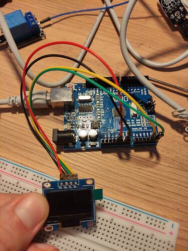

Hi. I bought the following OLED display:
I am using an UNO copy.
First I wired it up as described on the sellers page on Aliexpress, and followed their instructions regarding installing the u8g2 library and I copied their example code, all included in the link above.
When I upload the code nothing happens.
Then I followed the instructions described here:
I installed all the libraries and followed all the instructions, except when I run any code to find the I2C's address I run in to an error.
The Serial monitor only writes "I2C Scanner Scanning..." and nothing more. When I press the reset button on the Ardurino it writes the same message again, but that's all.
I used the A5 pin to control a relay earlier, so the pin itself should work fine in theory.
Do you have any idea what could be the issue here?
If I missed any detail you need for helping please ask and thank you for any input!
P.s.: I run into the same issue when I try to find the address of an I2C module soldered to the basic 2 row LCD screen which comes with the basic kit. (and when I wire this setup and power it all I get is the back light and the first row is on with solid bars)

Hi. The problem seems to be that I can not even locate the address of the module. As the I2C address scanner does not work. Looks like the Arduino is not able to communicate with the display maybe?
Maybe verify:
I2C Termination resistors - Using Arduino / Project Guidance - Arduino Forum
Make sure A4 & A5 actually work. Easy method is see if you can blink an LED using those pins. Also check the jumper wires, they can break inside the insulation.
Thank you! I checked both A4 & A5 pins and all four cables, I can blink an LED with them without issues. So at least the pins and cables are working. Then I re-tried the I2C scan, but no change.
This is my working program on UNO and I2COLED setup.

Can you verify that you are actually getting a good ground and 5 volts to the display?
Do the jumper wires fit proper on the display?
Have you got a 4K7 resistor on each of the I2C wires going to 5V.
@GolamMostafa
  1. I connected the I2CLCD with UNO (VCC to 5V, GND to GND, SDA to A4, SCL to A5) then connected the UNO to the laptop, the the back light turned on with the first row of solid bars as usual. I updated the code, but nothing changed. Not even the SerialPort write any messages contrary to what it should have been done based on the code.
    2., 3. : same results except the back light, of course
I checked the A5 and A4 pins again, this time with a DHT22 humidity and temp sensor, all good.
@david_2018 yes the back light lights up, so I assume there is power, it also powered the DHT22 sensor.
@TomGeorge I am not sure what you mean. Only one I2C wire goes to 5V, the VCC. If it is a joke, sorry I am new to this, I have no chance to pick it up :smiley:
It would help to learn a bit about how I2C works. I suggest this introduction.
The chances are good from Aliexpress that you have a fake or nonfunctional display. If you want a display that will actually work, with excellent "getting started" tutorials and product support, check out Adafruit's offerings.
Which message of the following two, the uploading of the sketch of post #14 shows on the Serial Monitor?
1. I2CLCD is not found!
2. I2CLCD is found!
@jremington thanks for the article, it seems easy to follow, I appreciate it.
In the review it was working for many pll, with photos. Maybe I fell for it and the reviews were fake too?! :smiley:
Do they look legit to you?
But any the I2CLCD was part of the basic kit, and everything works from there. And I also have the problem with that. Can even find it's address with the I2C address scanner.
