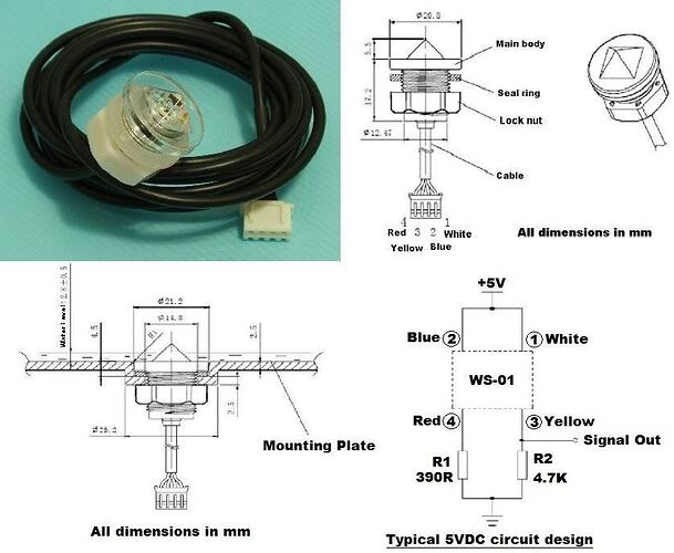

Im using an optical liquid sensor to activate a DC water pump when the water level becomes low in my fish tank. I've got most if it figured out except for one problem I'm having. When the sensor triggers the sainsmart SSR it turn ON the pump the SSR does not turn off the 9v DC pump, it just stays on.

here is the recommended wiring for optical water sensor.
