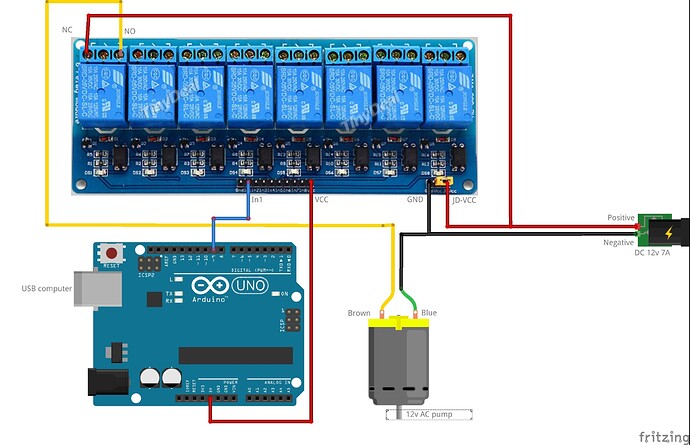

I followed my previous wiring (attached diagram)
but the 12V-AC pump not powered
You will need to switch one line of the 12VAC from COM to NO.
EDIT: Diagram deleted (incorrect)
because what i tried before is DC positive to COM
did you mean move DC positive to NC?
it didn't work like the diagram below
You are supplying 12v to JDVCC! This is supposed to be 5v. I suspect you've blown some components on the control circuitry.
KenF:
originally, VCC & JDVCC (at the bottom right) is pin shorted
last time i remove the jumper and supply 6v DC to JDVCC, it works work with the DC motor(at the same time, the centre VCC to 5V Arduino)
what do you think i should do this time?

so the relay should separately powered through JDVCC with 12V-DC+ and GND with 12V-DC-, right?
Your diagram shows NO and NC ... this could never work.
Should be NO and COM (outermost relay terminals) for normally OFF operation.
Energizing relay switches the load ON
Should be NC and COM for normally ON operation.
Energizing relay switches the load OFF

Would you please take a look on my #1 diagram
I think it is NC, COM, NO (from left to right)
#1 diagram is work for my DC motor
is the wiring correct for AC-pump too?
The white silkscreen is actually a diagram of the contacts:
So its NO, NC, COM. Oops ... NO, COM, NC
am i the same COM NO NC ?
See image
From the picture, it shows NO, NC, COM (left to right). Oops again, NO, COM, NC
With a multimeter, you could do a continuity test or measure the resistance from COM to NC, then COM to NO.
dlloyd:
then i should have the same relay layout like yours at #3
i tried again, click sound, but the AC-pump not work
