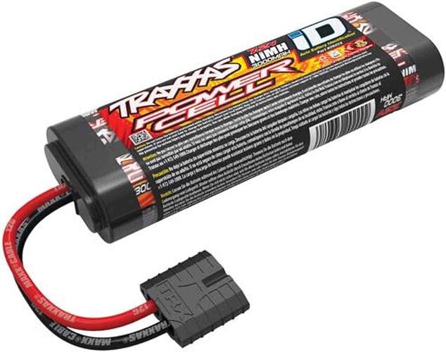

I prefer RC style 2S lipo packs that can easily connect via whatever connector yours come with (EC-3, Traxxas, Deans, whatever) to Arduino (5.5mm OD, 2.1mm ID iirc?) barrel jack.
With an RC hobby charger, it's easy to balance charge these types of batteries and add a low-voltage lipo alarm to the balance lead in your project to avoid over discharging.
An alternative to these is, using the same charger from RC hobby, use NiMh batteries of 7.2 or 8.4V or such and don't worry about all the storage needs and concerns of lipos at all. Chances are one's Arduino project doesn't require the energy density advantage that lipos are great for, such as in drones. NiMh are more affordable, very safe and compact. Look for 1/10 or 1/16 scale stick packs by companies such as Traxxas.

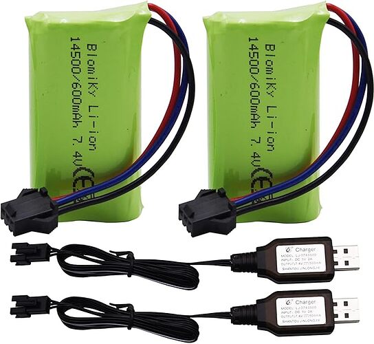

The picture shows a pack designed for very high discharge currents.
Could be very dangerous in the hands of a beginner.
If the pack that Terry posted has a protection board included, then that is a much safer solution for an Uno.
Leo..

How? It's NiMh. Plugged into an Arduino, the current will be what the Arduino demands. For accessory devices such as servos, pick off a line between the battery and devices and run it into a buck converter dialed in for 5-6V (in a servo example).
I do this all the time and in fact, prefer this to lipo solutions of similar capacity.
I only use lipo when I need that energy density for things like BLDC motors or the small form factor I can get away with lipo shorty packs in brushed motor rock crawlers (7.4V, 3300mAh is a good one on a 1/10 scale crawler such as the Losi Night Crawler - good half hour or so runtime, easy placement on front end over servo allows the stock battery tray to be used for other things. In my case, a multi gas alarm for culvert/under rail car inspections in a prototype and also a Fat Shark FPV camera system all on the one battery).
Most of the time, that's not necessary. NiMh will get the job done in the same way @sonofcy refers with AA alkaline batteries, although having the rechargeable advantage.
For larger projects that can accommodate the space and don't move around, I choose 12V, 5-7 (ish) Ah sealed lead acid batteries such as those in fire alarm system control panel battery backups. Cheap as chips, great runtime, non-spillable, connectors are very common at any hardware store.
That's just me. Lipos are great when the right care is taken and you know their inherent risks. How many among us store our lipos outside our homes and in something like a steel ammunition box when not is use? If you don't, you should...

One project will be a very light simple robot with a laser-cut cardboard base, The batteries I showed would be light enough. And the fact that they come WITH a balancing charger for $8 total or so makes it affordable for school projects and each kid can take theirs home WITH a charger.
