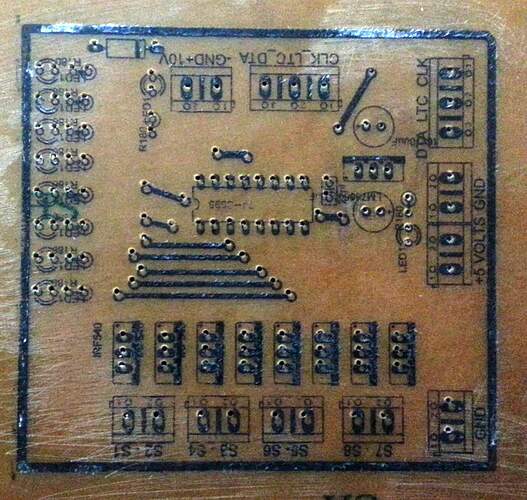

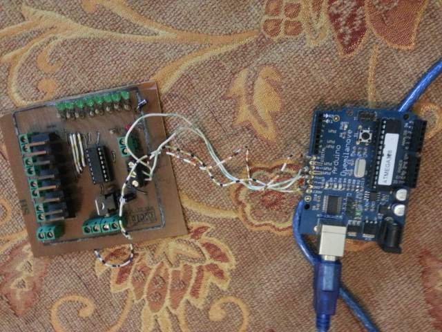

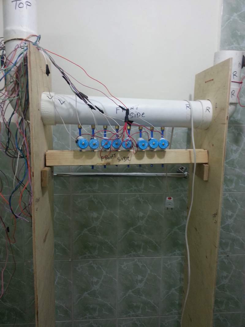

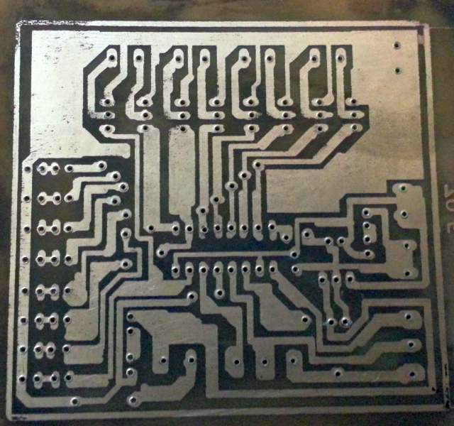

This time i am making proper hardware and hope it will be success. I just completed 16valves electronics controller for solenoids. These modules will be added as solenoid valve increases.
I just need help in above posted arduino code. I want to make a communication protocol so that no waste byte affect the overall design.

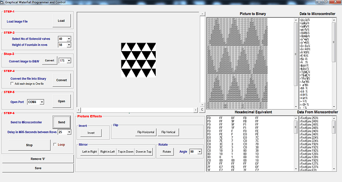

Okay guys here is a brief update:
1- Handshake protocol is one of the difficult thing as the Picture converted into every type of EXTENDED CHARACTERS. So making protocol was a bit difficult task however the software is now working great:
Protocol is like:
XYZ%
= Start of byte
XYZ = three bytes i.e. 8x3= Solenoid valves
% = end of byte and send to shift register
We have all sort of ASCII characters incoming in serial port from VisualBasic to Arduino. We have to make a protocol so that we know that the bytes that are coming having START OF LINE > and END OF LINE% character as per protocol defined above. We have to precisely pick the two bytes between > and %. for example

2- Prepared the electronics and tested with the software and its performing brilliantly.

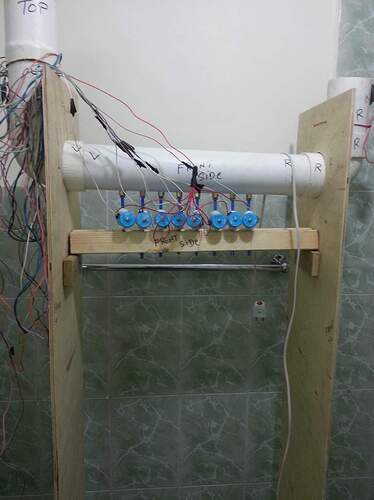

3- One of my friend sent me the waterfall pre-fabricated and now its in washroom for test purpose. it has 8 valves only will be very less resolution but i hope this time we will succeed.
The waterfall has crude hardware setup. Tomorrow i will test it with my totally changed Arduino sketch and modified software.

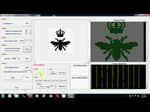

Total success...Here is the video. Unfortunately, the mobile camera was laying horizontal throughout the video. This video has small clips in which i am manipulating and optimizing my software for better results. The first clip showing arrow fall. In the subsequent videos various testing to optimize setting.
https://www.dropbox.com/s/s00hajwkppfw37n/20131123_192521_MPEG_.mpg
Unfortunately 8 valves gives bad resolution. i sent the video to fountain guy and he was amazed to see the results. He started fabricating 40 valves waterfall. Moreover i told him to add strong LED lighting just at each valve so that visibility come clear.
Few improvements he will do , i am sharing so that anybody interested can get it right for the first time.
1- Waterfall must have atleast 24 solenoid valves
2- Waterfall height must be 8ft or bigger
3- LED lights on each valve will make the falling water visible and beautify the look of falls.
4- Add black curtain behind.

Here is improved software interface.

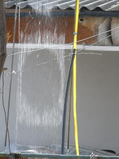

Finally a success...We have tested 64 solenoid valves waterfall all day long in our FunFair community show for charity fund raising. Lightning and background still needs improvement however technically we have a very good response from the computer-electronics-hardware communication. The handshake protocol worked flawlessly.
Here is the video. The header is at atmospheric pressure and outlet of solenoid valve is 6mm.

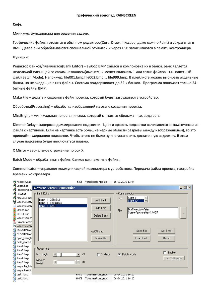

Hi Khalid.
Thank you for sharing results with us. It is huge amount of work for hobby project.
I'm also in waterfall area since 2009. My work was conroller, firmware, PC software and power logic. Processor was ATmega324(not arduino based system) and pictures stored in flash memory card.
Last summer we launched it in full power - 256 solenoids. Of course it was commercial project :).
Some notes on my system(in Russian) with pictures you can download here:

Excellent work. I wonder, how two different approaches were meet to make such a graphical waterfall. I don't know why you have used sliders (scroll bars) for delay.
Thanks for sharing:)
Delay scroll bars:
Dimmer delay - impacts on backlight. Program scans image and for each horizontal line produces color and intensity of backlight. At the end of image there could be black pixels. So backlight will be flashing. For that reason backlight dimms smoothly from current intensity to zero. And this slider sets speed of dimming.
Jet calibration sliders. Valves have mechanical variations and speed of their reaction will be different. This group of sliders helps to slow down too fast valves and slightly compensate their variations. Because of limited AVR 8-bit processor perfomance this feature was realized on PC side. The payment is ten times larger files. But user can disable this feature and save space on memory card.
