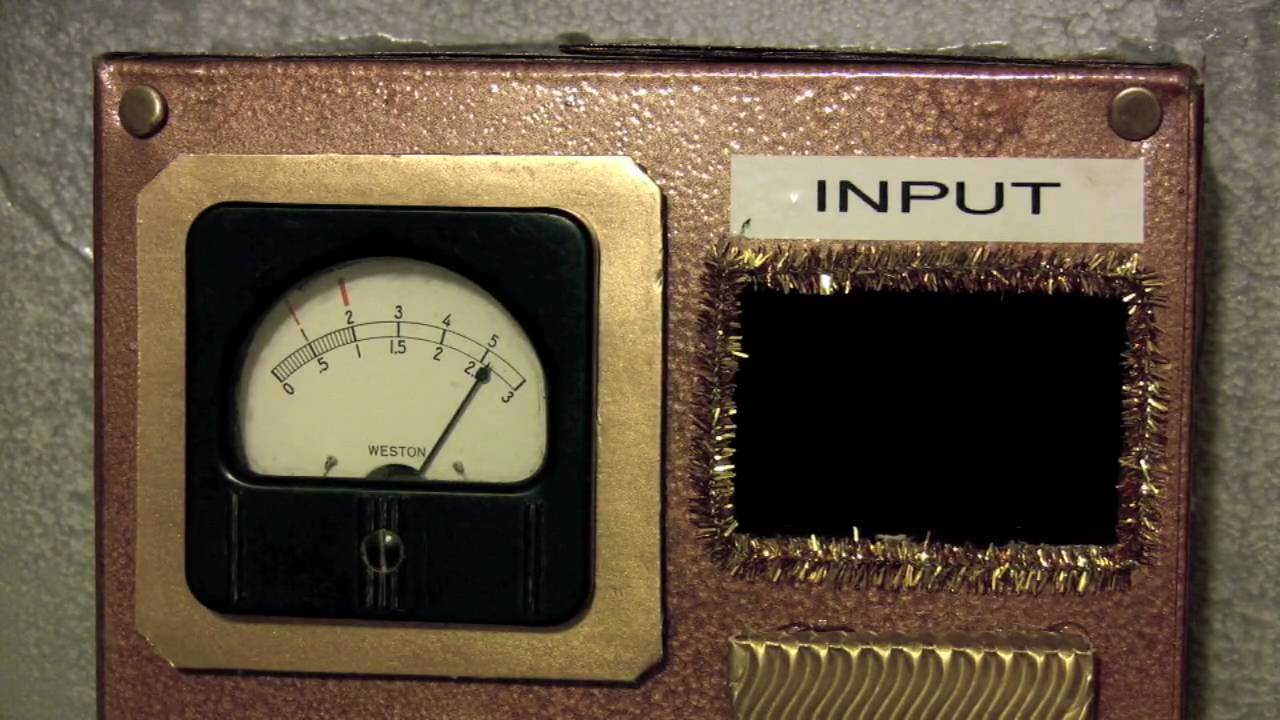

We finished the costume, just barely in time for trick-or-treating.
Here's some photos, and a video of the electronics in action.
neosurreal: The sound is driven with an Adafruit Wave Shield, and the sounds were a loop I found on my Mac, as well as some recorded speech synthesis, also done on my Mac.
The Arduino had no problem continuously playing sounds, chasing the LEDs, and reacting to an input while also driving a PWM output for the gauge.

Costume features:
Chaser LEDs surrounding the Aruino. People will want to know how it all works,
so we want to show off the fact that there's a computer in there. Will be
mounted on the back of the costume, so this will also be a visibility safety
feature.
Candy input slot / Analog gauge. There is an electric eye in the input slot
(with a .75 sec debounce/guard time), and the gauge indicates that candy has been
received, climbing higher with each piece inserted, until the desired amount of
candy has been exceeded, at which point the giver will be rewarded with the
gauge going crazy! (That is, the needle will swing back and forth wildly.) Then,
after an amount of time, the gauge will reset, so the needle is back to 0 at the
next house. This time is enough to get a laugh without showing the giver that it
resets, but not so long that the next house sees the needle still going crazy.
Sound effects via Adafruit Wave Shield. There's an idle loop playing robot
beeps, which gets interrupted by candy input. When the candy count increases,
there is a synthesized speech recording that will be played, a different one for
each quantity. When playback of one of those files completes, the idle loop
starts again.
[Still need to document the circuits.]
