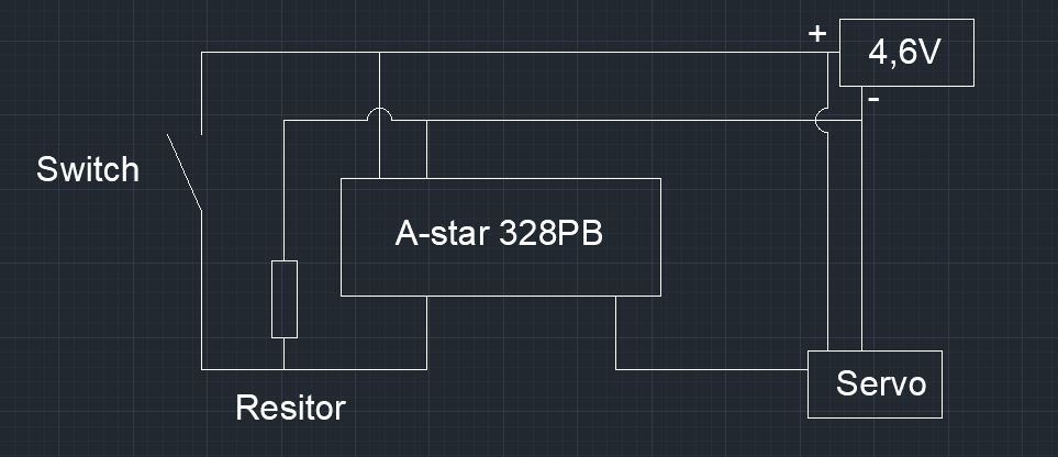

This is my Setup
Okay, we know that code can't make your board run hot. So please post a schematic drawing instead of trying to describe the circuit verbally. It sometimes helps to also post images of the actual hardware.
Edit - That shows the circuit. It appears correct, although the A-star pins are not labeled. I have to assume that you constructed it differently, so please post clear close up images of your actual hardware.

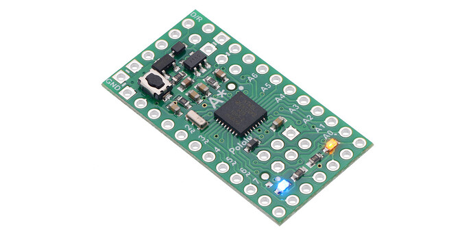

Great, how about a link to the board you're using. It's not very common. I would like to know what the pin out is.
aarg:
Using pin 2 and Pin 9
You seem to be powering from the BAT pin. Is that correct? What voltage are you applying there? According to Polulu, it has to be at least 5.5V.

Schematic of OPs 328 board;
Tom.... :slight_smile:
This board is a little different than most, I was not aware of VCCIN, you should probably apply your 4.6V to it, not VCC.
