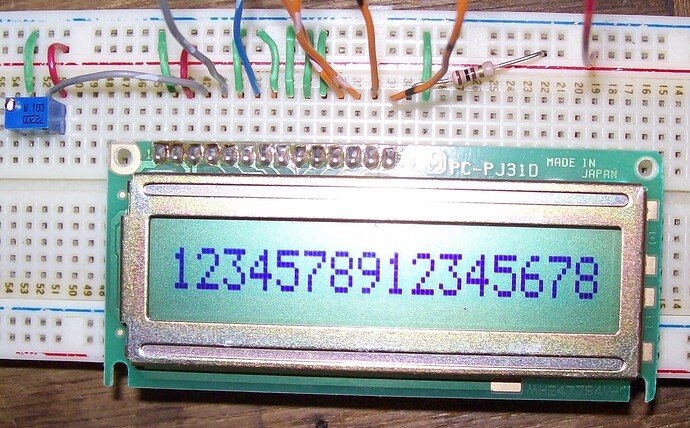

I have this display that I bought for $2 can at a surplus store. It look like a 16 X 1. No datasheet ( I try to find it ) So I find a datasheet of a different display ( parallel type ) and maybe the pinout are standard ? Ok, I look at this tutorial to how to connect a LCD - parallel type Arduino Tutorial - connecting a parallel LCD Guess what ? IT WORK !! But not realy. I saw "Hello World" and the seconds. Hello word was cut off, and the second start next to it. ??? Mmm ??? So I modify the program "Hello World" and here the code and a picture. It work better in this mode. I just don't want to throw away this LCD. I guess I will not.

I think 16X1 display organizes it memory like a 8X2 display so the first 8 characters are line 1 and the next 8 are line 2.
Humm... That will explain. So therefore when I use this LCD, I have to bear in mind "this" feature during programing and display info / data. Well at least, it was a twonnie well spend. ( the $ 2 coin canadian term )
Not all 16x1 displays, just the vast majority of them.

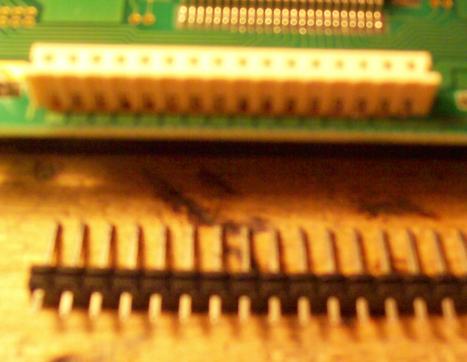

Thanks for the link. Impressive work. I have already 3 16X2 and 1 20X2. <--- I need a new heathers, not the one who fit the breadboard but smaller one. I don't know where to get it ..and some "adapter" to fit into 0.1.

liudr, here a picture of what I am talking about. The 20X2 is the top ( small, don't fit the standard header. The bottom is the standard header. So I will like to use the 20X2 display. Not shoving wires into the header.
Measure the distance between the two farthest holes and see if you get 38mm. From the picture I suspect it is 2mm spacing.
Yes. The top one is 2mm and the bottom is larger. I know they don't fit so where can I find 2mm header and "adapter" to fit a breadboard ? Because the 2mm don't fit the breadboard.
I wish I knew a part. tried googling 2mm 1" adapter and the first few hits don't seem to help much.
