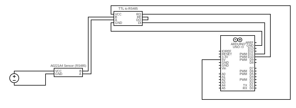

Hello all, i am using the a RS485 ultrasonic sensor module "A0221A4". I connected the sensor to a TTL to RS-485 module and connected the module to the arduino uno over pin 10 and 11 to act as RX-TX pins.
I am trying to send a command to the RS485 module to get the distance via softwareserial and failing. is there a specific library or an arduino uno example to use for that sensor. You can find the rs485 command data sheet for that sensor in this link https://www.aliexpress.com/item/1005003691760080.html
The following is the circuit used:

All of those ground pins need to be tied together so you have a common ground across the entire system.

Thanks for the reply. As you mentioned i tried connecting the ground together and it was the same thing. Also after sending the 8byte hex code of get_address i am not getting anything as a reply.

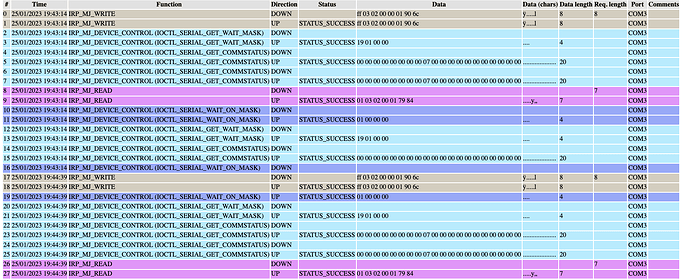

N.B. I tried the sensor by directly connecting it to pc vial usb-rs485 adapter and did get a reply from the sensor using a serial monitor software. The modbus hex sent was ff 03 02 00 00 01 90 6c and the received data was 01 03 02 00 01 79 84 which is correct.
The bus transceiver controls RE and DO are not connected. In that case, the transceiver can't change the bus data direction. As well as connecting them, they have to be controlled in software.
yes.
and the transmitter needs to be enabled during transmission. flush() can be called to wait for transmission to complete and the transmitted disabled allowing reception of a response

i don't believe that's necessary for the balance pair rs-485 signal. there's no common ground between a USB rs-485 adapter and rs-485 bus
There should be some common ground, at least through safety ground. But it isn't part of the signal path at all. It will operate without it.

Also this is an example from the serial monitor on pc of how the messaging happened in the serial monitor software:
