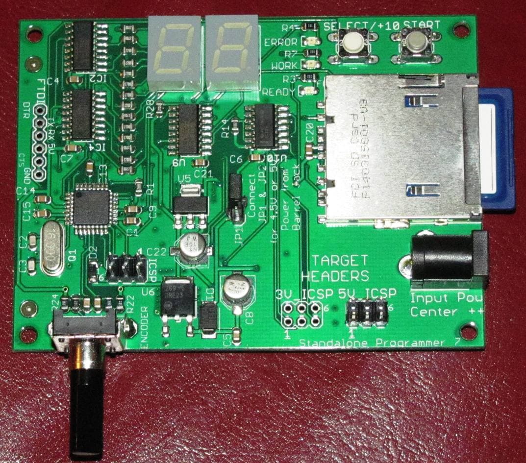

There are programmers that can store different codes; e.g. Cross Roads Electronics
