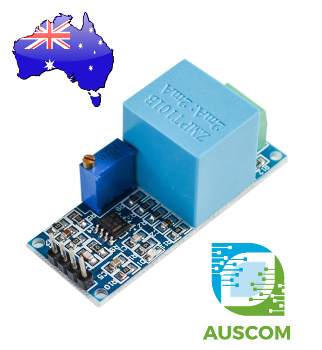

Hi @myksj
380Vac is that RMS or peak.
ZMPT101B is rated for;
Tom,
That rating of "up to 250V" is for the module.
I believe that myksj is using the bare transformer alone, (maybe he'll correct me if I'm wrong), so that limit does not apply.
The transformer itself operates at a low voltage, and current up to 2mA.
The majority of the voltage is dropped across the series resistor on the input.
High voltage techniques should be used when building the circuits suggested.
Use several resistors in series to make up the 340kΩ, as standard resistors are generally rated at 200V or less.

  1. I'm going to proceed like '@JohnLincoln' said.
  2. Resistance value : 380K(value) =~ 200k(1W) + 200k(1W)
  3. 380V applied voltage = V1(R1) + V2(R2) + V3(ZMPT)
I'm trying to configure it as above. I don't think there will be any problem in terms of internal pressure.
