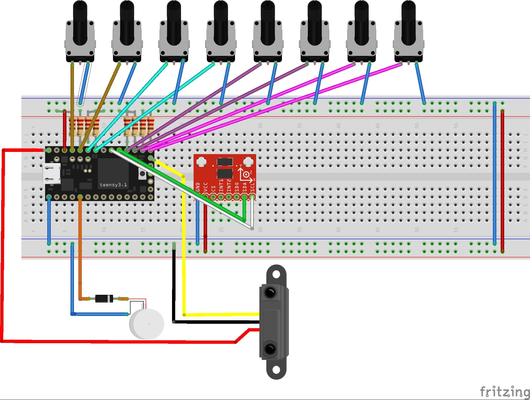

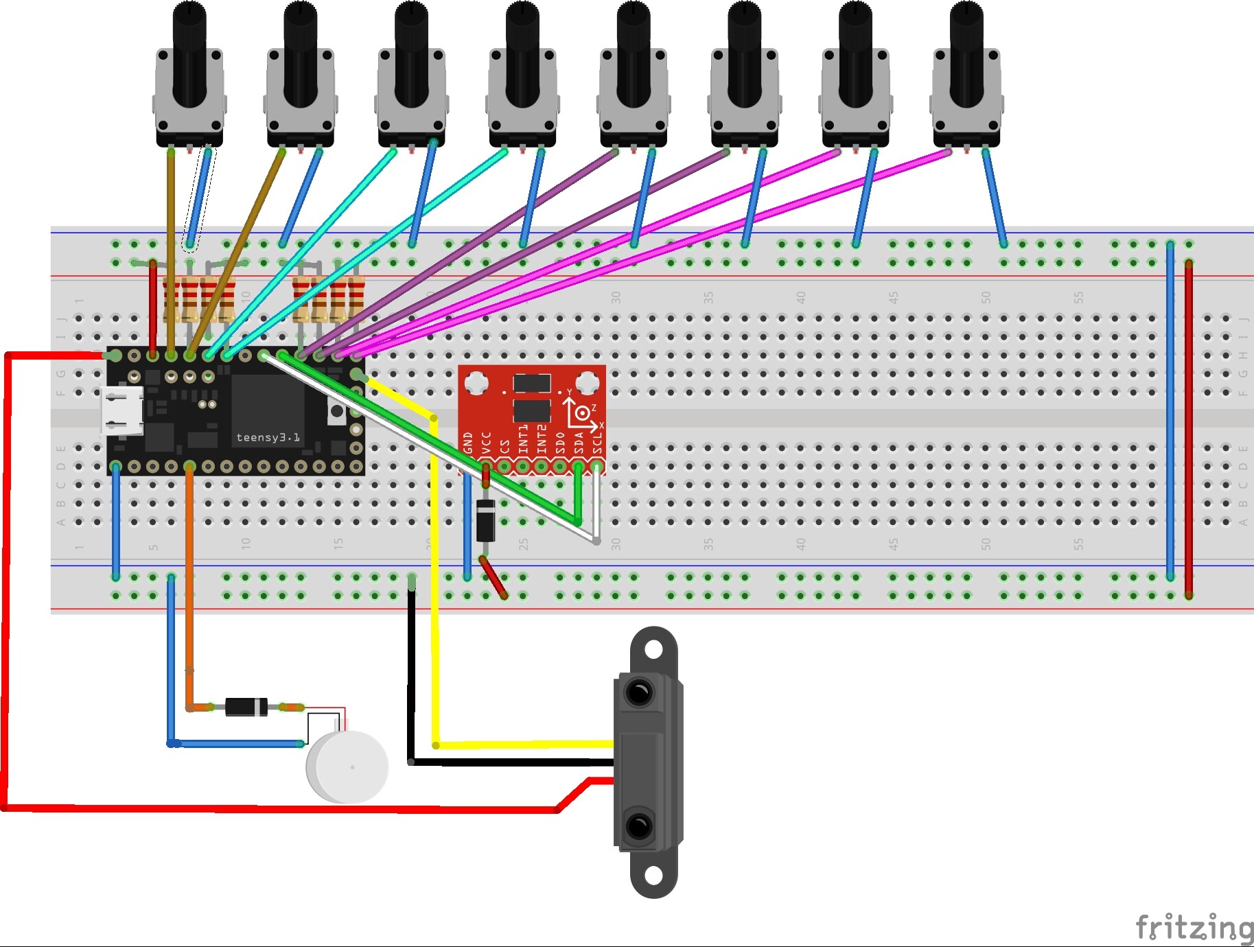

“Can you please post a copy of your circuit, in CAD or a picture of a hand drawn circuit in jpg, png?“

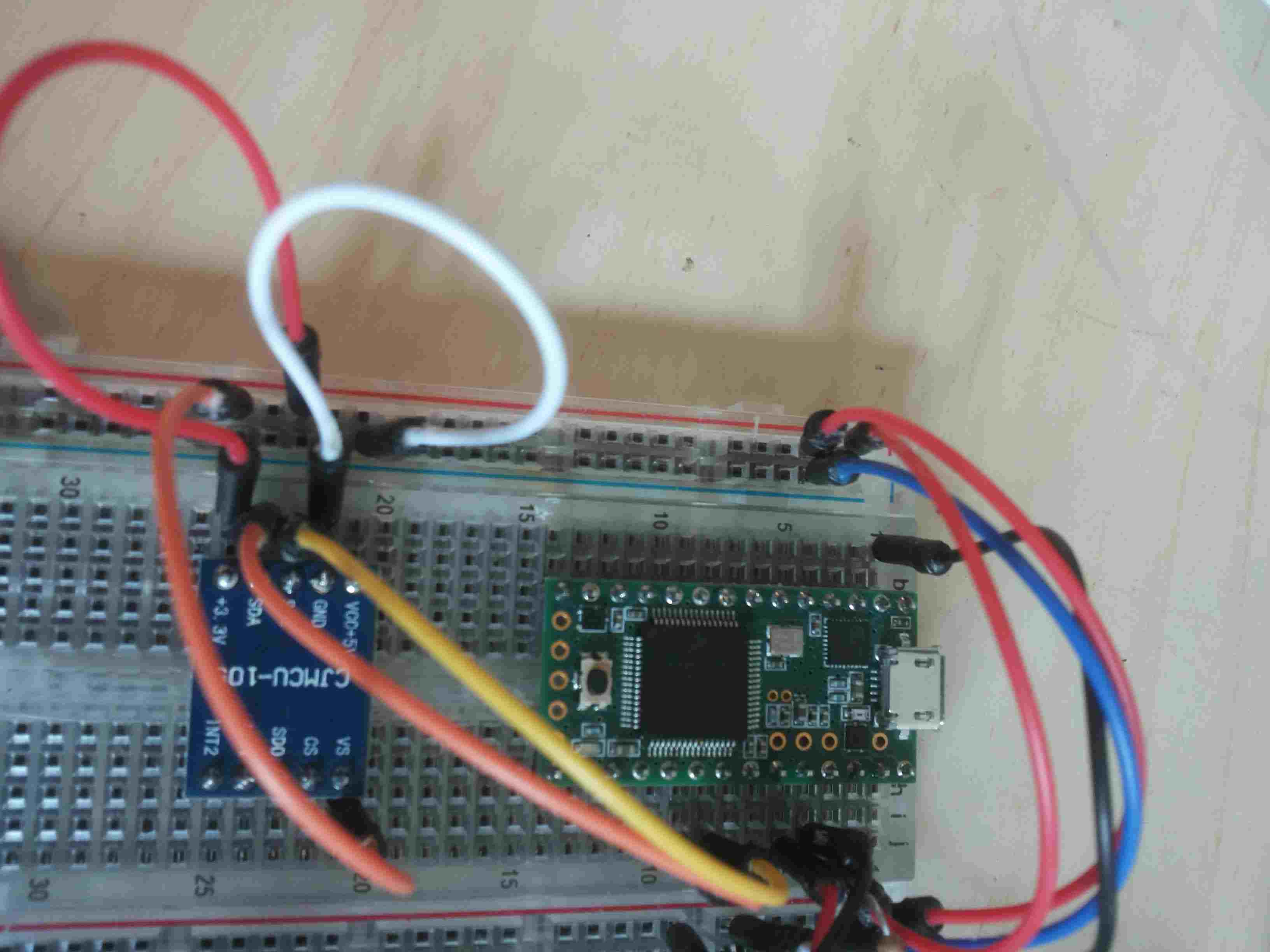

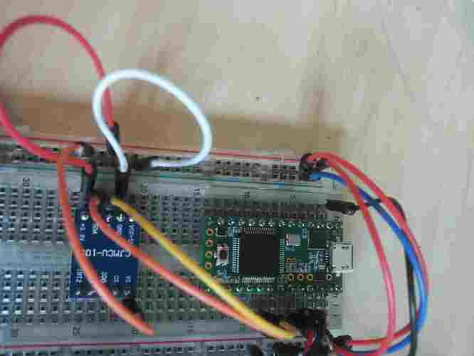

Yes, photos and fritz below (im new to electronics, so I apologize for any mistakes in the fritzing..)
no, im not using a capacitator, I might later on even though I would rather keep smoothing digital since the chips will be part of the glove, so any additional hardware will just make it bulkier. In any case, since I do get a very stable output from the accelerometer by itself, I first want to try fixing the problem as it is.
The resistors are 12.6k, and as you can see from the photo the accelerometer is a different one, but I can assure you it is connected correctly. The infrared sensor is connected to the 5v channel, but that hasnt been a problem before either. The last photo shows the setup on a different board with the same chips. the bend sensors in the fritzing are represented as pots.

here the new fritzing
This will be because the ADXL354 will have some bypassing and DC filtering capacitors on it.
By fitting the diode you isolate to some extent the variations or noise the the other loads are putting on the 5V supply.
As I suggested on post #2 for you to add bypassing to the power input of the ADXL354.
The diode on the motor is also wrong, It should be in parallel with the motor, cathode to the positive end of the motor, anode to the negative end of the motor.
Tom.... :slight_smile:
Uh, ya, putting the diode on the motor like that probably makes things worse, not better. And you shouldn't switch a motor directly with an IO pin, use a transistor or fet to switch it.
Also - put some caps on for power supply filtering and bypassing - some small ceramic ones right near the accelerometer, and maybe a larger electrolytic (couple hundred uf?) on the supply for filtering.
This is your reference.
Did you read and look at it?
You need to build that circuit, not how you have it.
