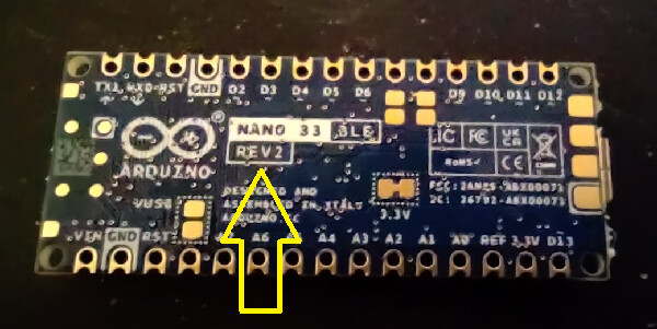

The secondary side of your board looks just like this then --
Yeah... I'll have to test this out a bit more. Thank you though Mr. Pancake!!
