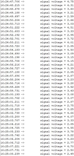

To check the signal i did some tests with the following code:
Serial.print("\t signal voltage = ");
Serial.println(5/1024.0*analogRead(A8),2);
During this test the current clamp measured between the 10 and 12 Amps. the results from the arduino are below, the ACS 712 has a max Amp rate of 20 Amps

so first, the ACS712 is at 2.5 V if it doesn't measure any current. it goes below 2.5 for negative current of AC.
In your test sketch do
Serial.println(analogRead(A8));
Your code in post#1 is for AC, and won't work for DC.
This test sketch should work with a 5volt-logic Arduino and a 20Amp ACS712.
If the readout from this sketch is not correct, then it could be PWM of the motor/driver.
That can be fixed with smoothing code (multiple samples).
Leo..
