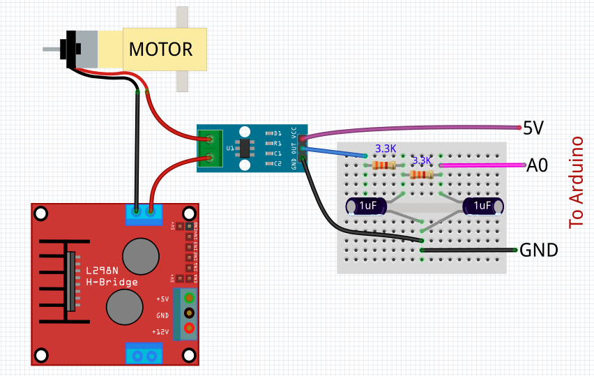

I need a help for the connection of ACS712 sensor to measure current of dc motor and L298N module, Arduino UNO
Get a ACS712 breakout board and connect it to GND, VCC and any analog input.
Hint: modern motor driver boards have integrated current measurement feature.

My diagram shows the generic ACS712 breakout board

i am using this breakout board

Also one more thing, can you please verify my code, if any changes is required?
const int ACS712_PIN = A0;
const float ACS712_SENSITIVITY = 0.185;
int sensorValue = analogRead(ACS712_PIN);
float voltage = sensorValue * (5.0 / 1023.0);
float current = voltage / ACS712_SENSITIVITY;
Serial.print("Current: ");
Serial.print(current, 2);
Serial.println(" A");
delay(1000); }
this is only for current measurement
int sensorValue;
  sensorValue = analogRead(ACS712_PIN); // dummy read
  // Read it twice and take the average (divide by 2)
  sensorValue = sensorValue + analogRead(ACS712_PIN);
  sensorValue = sensorValue - 1024; // Subtract out the midpoint (512 x 2)
  float voltage = sensorValue * (5.0 / 2048.0); // (5.0 / 1024.0) / 2.0

Does not work if PWM is used
Okay.
I have to use PWM for the motor, so what can i do next, if this is not applicable
You can still use the ACS712 but the software becomes somewhat complicated.
It might make more sense to use a different driver with a current monitor output.
What motor are you using?
It is 12V brush motor with encoder
You will need to build a little filter circuit like this
You will need two 3.3K ohm resisors and two 1uF capacitors.

do the code described above needs any changes?
No.
FYI: The current can be positive or negative depending on the motor direction
