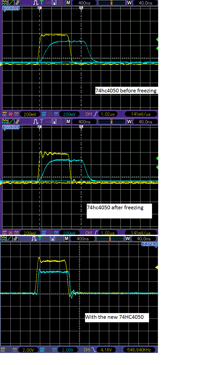

I too had this problem; however, it would sometimes only work on cold mornings for a few minutes and then lockup. I spent many hours going through the software which seen to be ok.
It seemed to be a timing problem so using an oscilloscope and measured the signal through the 74HC4050, a level converter from 5V to 3V, and found quite a long delay. The rise delay was 47nS and the fall delay was 58nS. This was far too great for the SPI and was out of specifications according to the data sheet.
The other thing I noticed when I hit the 74HC4050 with freeze spray, causing the delay to decrease, the CC3000 board would operate until the chip warmed up. As timing in a chip is not something that is caused by a fault, all I can assume is the board (this was a Chinese copy of CC3000) was fitted with a counterfeit 74HC4050. I replaced the chip with a genuine 74HC4050 and the board worked faultlessly. The delay through the new chip is now 6nS.
The lesson I learnt from this is that it doesn’t pay to buy copies if you value your time and sanity.

I take the assumption that the board was tested in the factory before it was shipped. The factory in China may have been really cold the day when the tested causing the counterfeit 74HC4050 to operate just fast enough to work. Try putting the cc3000 into the freezer (Ice box of the fridge in a plastic bag) and then try starting when it is really cold. If it does work, it is most likely the 74HC4050. There are plenty of YouTube video on how to replace the chips. You can also confirm that it is 74HC4050 it using freeze spray and only freezing the 74hc4050. The freeze spray can be obtained from the local electronics shop.
