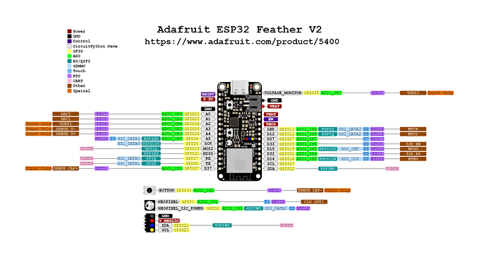

Also this is the pin out of the controller board.

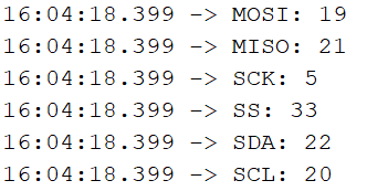

I think they are at GPIO22 (SDA) and GPIO20 (SCL). Also Y_LED and G_LED and TFT_IM0 and TFT_IM1 are at those pins. Those pins are busy pins :scream:

I am able to print them out with:
#include <Streaming.h>
  while (!Serial) {
  Serial.print("MOSI: ");
  Serial.println(MOSI);
  Serial.print("MISO: ");
  Serial.println(MISO);
  Serial.print("SCK: ");
  Serial.println(SCK);
  Serial.print("SS: ");
  Serial.println(SS);
  Serial << "SDA: " << SDA << endl;
  Serial << "SCL: " << SCL << endl;
Capture
Hey @Koepel I am trying not to use the I2C bus but use the two pins for the I2C bus as GPIO. It is just strange that it doesn't work directly from default as GPIO. Therefore, I was wondering if anyone has had experience with this board using I2C pins as GPIOs?
GPIO20 and GPIO22 are normal digital pins.
You should be able to use pinMode() and digitalRead() and digitalWrite().
You have "MAX17048" in your sketch, so I assumed that you are using the I2C bus.
Then you have also a TFT_IMO and TFT_IM1 on those pins and leds.
The sketch that you showed does not compile and you use pins 20 and 21 three times and now you want to use them as normal digital input and output pins. So you want to use them 4 times.
You can use a pin only once.
