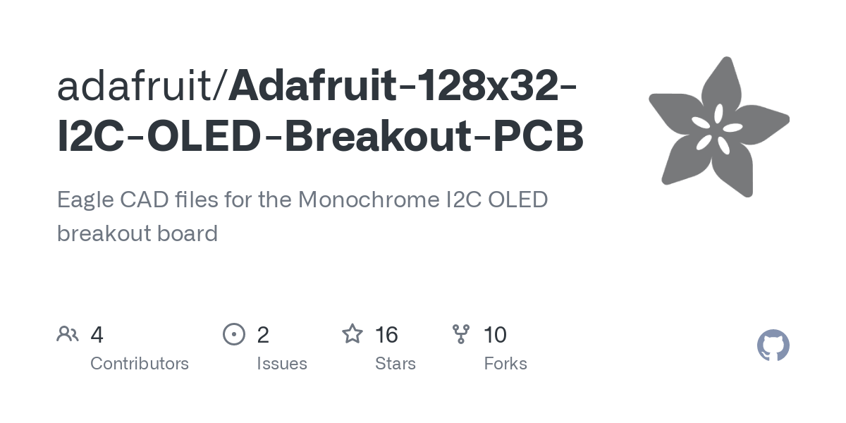

conradelektro,
It looks like the adafruit board has 10k pullups (see attached pic).
Sourced from:
It might be easier to remove those instead.
If you don't remove any resistors, the net effect would be a 4mA pulldown current. This is still in-spec for the SAM chip (source 3mA, sink 6mA). It's just unnecessarily stressful.

Chris,
thank you for posting the schematics of the "SSD1306 Monochrome 128x32 I2C OLED graphic display break out board", that clarifies my question very accurately.
I have to download the Eagle program to be able to look at schematics and board layout files. The schematics you posted are available at the Adafruit web site (as I found out just now), but one needs the Eagle program to display it.
Thanks to your answers I am now understanding the I2C pull up resistor issue. I already found steel tweezers with the correct gripper size to remove the offending 1 K pull up resistors from the Arduino Due board. I plan to heat the tweezers with the soldering iron (holding the tweezers with gloves to protect my fingers). Need to do some trials before manhandling the Arduino Due board.
