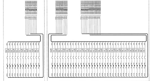

Hello,
I have an old Casio keyboard, model CTK50, a very simple one, no velocity, aftertouch, just a keyboard matrix being processed by an LSI which outputs some simple sounds. I'm trying to add MIDI in so I can play some midi clips from my PC or a sequencer and make the keyboard play from an external source. Luckily, I found the service manual (CASIO CTK-50 SERVICE MANUAL Pdf Download | ManualsLib) and I have the exact matrix used in this keyboard:
Then with the help of the service manual I found which pins in the ribbon cable are the KCs and the KIs:
So I wired up the arduino according to the schematic, using D2-D10 for the 9 KCs control signals and A0-A5 for the KIs input signals and using a simple 6N139 configuration for the midi connection.

Hi Mike, first of all, thanks for answering.
I want to send a midi message with a note from the pc, "faking" the keyboard; but I don't wan't to control the keyboard, I want to send a signal as if the key has been pressed when the key has not been pressed at all. It's like the arduino is a second keyboard sending 5V signals into the LSI. From the schematic, when pressing a key, let's say a D3, because we have KC3 on a side and KI3 on the other side, KI3 is initially set to 0V and KC3 to 5V (not continuously, but with the intervals that I wrote in the first post), and when the key is pressed we have a direct link between KC3 and KI3 so they are both at 5V. So the arduino when sending a midi note, for example the same D3, will have to scan when KC3 is high and send a 5V signal to the KI3 lane.
The original keyboard will not be scanned by the arduino, but as I said in the other post, when I set the outputs I have none of the two things working (the MIDI signals and the original keyboard signals), that made me thinking about putting diodes between the outputs and the ribbon (I also forgot to write that I put 470 Ohm resistor in series with each one of the outputs, to prevent high current circulation that can harm the arduino itself and the keyboard LSI)
