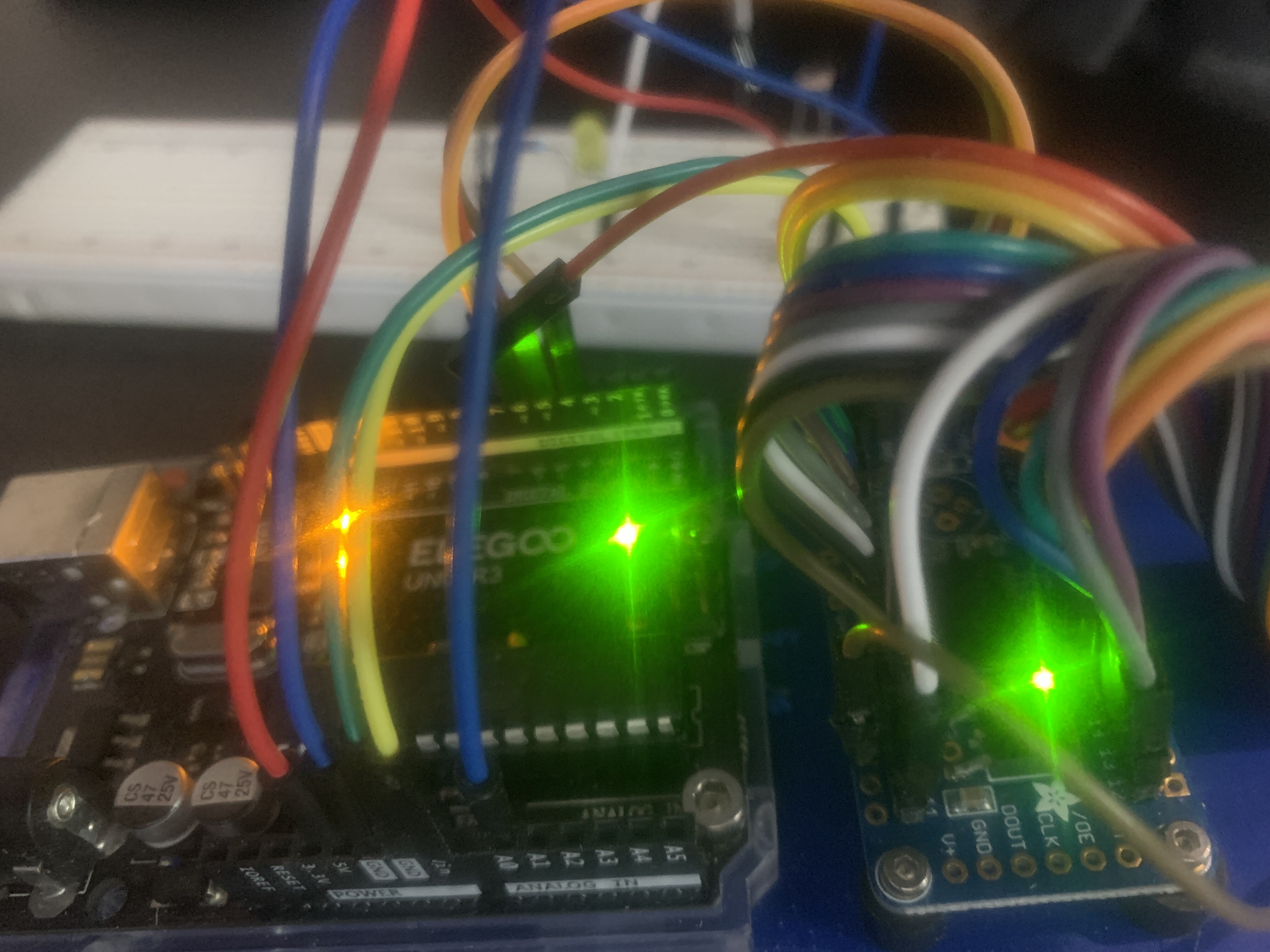

Show us your current sketch.
Always show us a good schematic of your proposed circuit.
Show us good images of your ‘actual’ wiring.
Give links to components.

Tried to upload a picture from my phone but I'm not sure how...sorry
On (my) phone, the image upload (arrow pointing up from a box) is located on the lower right, below the reply box.
Don't know if these pics help much ..Rest assured that covering and uncovering the LDR has the desired effect except for leaving the last lights on
