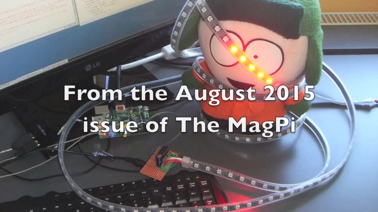

If the display is a simple running light or mass on/off, why go to the bother of using individually addressable LEDs in the first place?
How else can you have a running slug of lights it it is not with an addressable LED strip? Like this video:-
