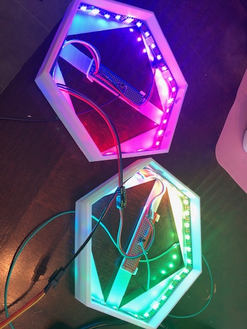

Hello,
I am new to Arduino and writing code. My background is in machine maintenance and little PLC work.
Here is what I am trying to create.
I am trying to create an interactive nanoleaf for my kids. I want my kids to be able to push on the cover of a hexagon panel, which will push a button to change the colors of the LEDS inside that hexagon panel. I want the hexagons to work independent from each other but have the same program. I was also trying to use the same data pin for each hexagon, so I don't have to wire each hexagon with two outputs (one for the push button and a second for the data). Right now, I am only using two hexagon panels to work on the code but going to have 8 by the time I am completed with the project.
what I am having a hard time with.
I would like to know how to address the pushbutton with the LED's that at just inside the panel. Currently my second push button doesn't work independently for the first and they work more in series with each other. Also, when working with the LEDS I seem to be able to only address all or I can set it up to work with the first 34 LED’s in the first hexagon or the second set of LEDs in the second hexagon.
I am currently using a neopixel file because that is how I was able to get close to what I am trying to accomplish. I wasn't able to use the same line of commands with the fasLED file to get as far as I am with the neopixel. (I understand that is because of me not knowing how to write code and not the FastLED file itself)
Any help on this is greatly appreciated

Your question has been asked many hundreds of times on the forum. You cannot run two patterns at the same time using code like this. It is "blocking" code, containing delays within loops. You need code which uses millis() for timing instead of delays within loops. Search the forum and find how others solved the same problem.
https://forum.arduino.cc/index.php?topic=715432.0
@PaulAB- Thank you, I'll look into more forms.
@grumpy_Mike Thank you for sharing your code using millis. I have a lot of research I need to do to understand your code so I know what it is that I am doing. I know this is a lot to ask but would you be willing to help me out with how do I would go about adding two buttons that is controlling 34 leds pre button, this way I can use your code as a reference for my project?
The best thing is to start off slowly, forget about the strip first just concentrate on getting the multitasking going first.
See my
http://www.thebox.myzen.co.uk/Tutorial/State_Machine.html
Or Robin2's several things at once
http://forum.arduino.cc/index.php?topic=223286.0
Anything you don't understand then ask specific questions about it.
You must eliminate your use of delay completely.
In your colorWipe function you dump data to the strip every time you set an LED and then delay. It is after you call the show function that you must end your functions code for that turn. This means that for loops can't be used and you have to do them "by hand". That is have a separate global or static variable that acts as the index counter, increment that each time the function is entered, and do the comparison to the end limit to see if you have finished.
While it is nothing too complex, if you are not comfortable with code you can get lost. Which is why it is good to build things up.
