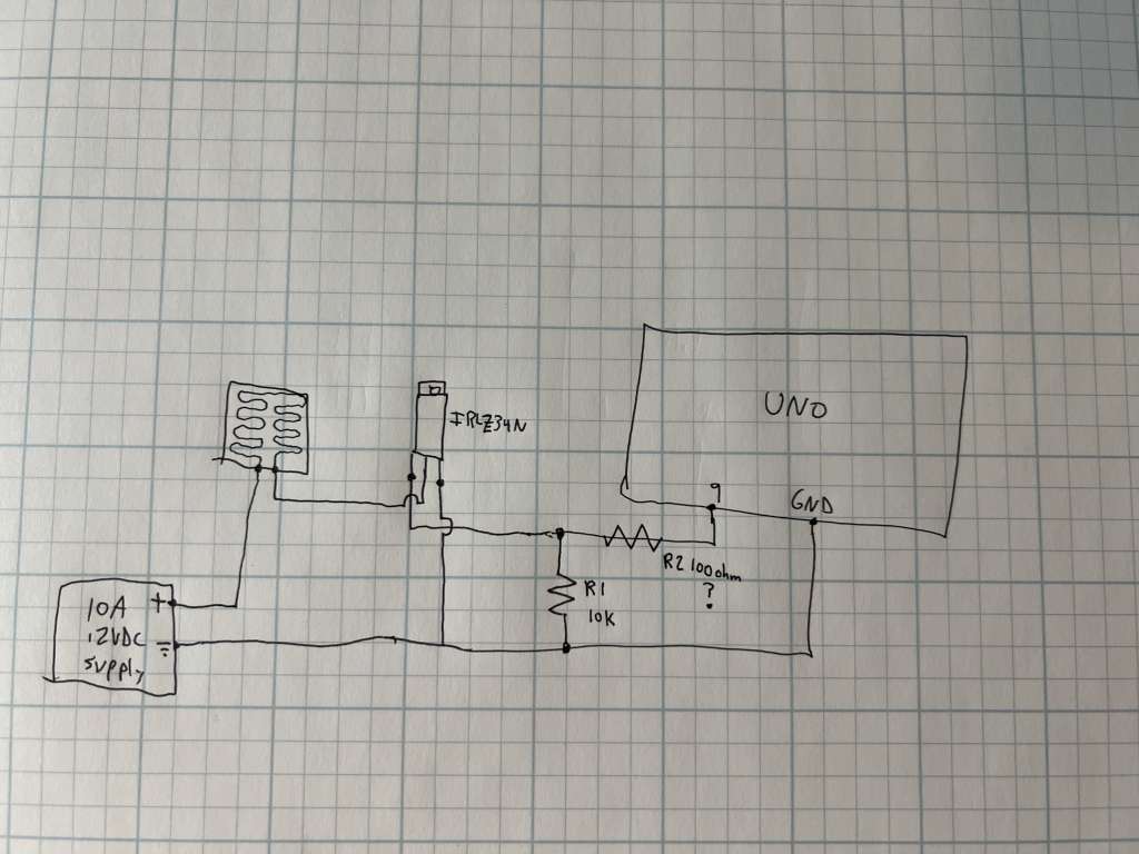

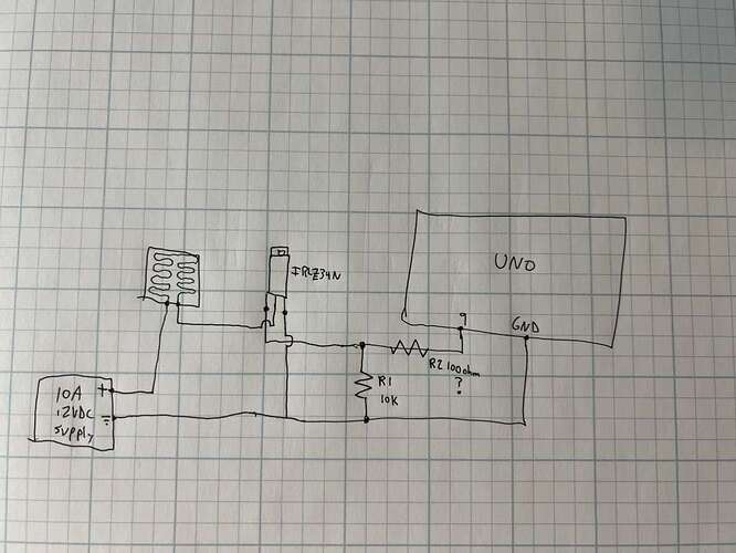

Here is my code, all hard coded just for clarity. This is really all I need to do in terms of heater control. Every week or two I may update the output value to tweak the power to the heater and will simply recompile and re-upload.
pinMode(9,OUTPUT);
analogWrite(9, 50);
Here is my sketch:
This is how I have not now but I don't have R2 installed. cedarlakeinstruments did I correctly capture here what you are suggesting with R2?
It's not a big deal with such a small resistor, but the 100ohm should go to the "left" of the 10k.
Got it thank you!
