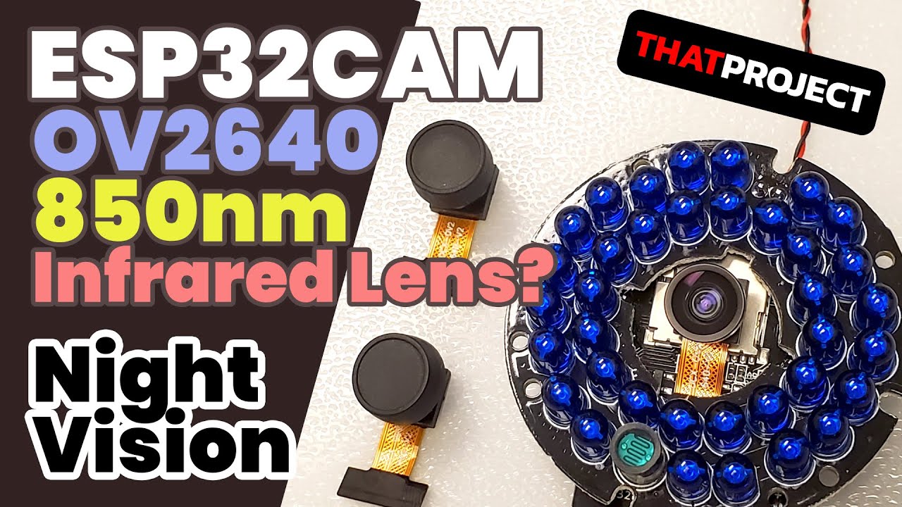

Where can this be bought? So if I understand it well, the OV2640 Lens could work in dark but the quality of the image is very bad. This guy added 12 IR leds to the camera and the image became very good. Now my question is how does this device now when to light the IR Leds and when to power them off? There should be a IR sensor as well no??? and it should communicate when to power on the IR leds and when to power them off.
My excuses, I just saw that there is a small LDR phototransistor. Is there a project link available with sketches, codes or explanations so we can apply the same thing?
Look carefully - there's a simple CdS LDR in the array.

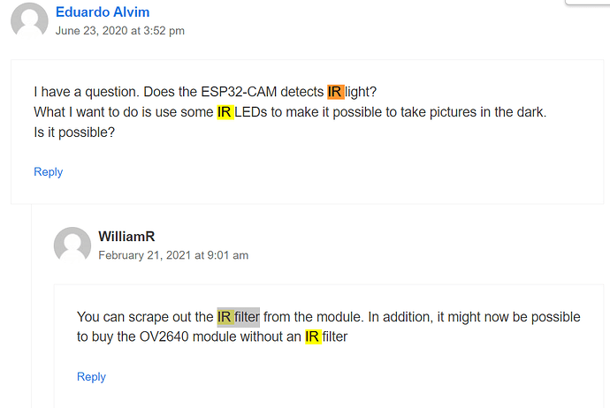

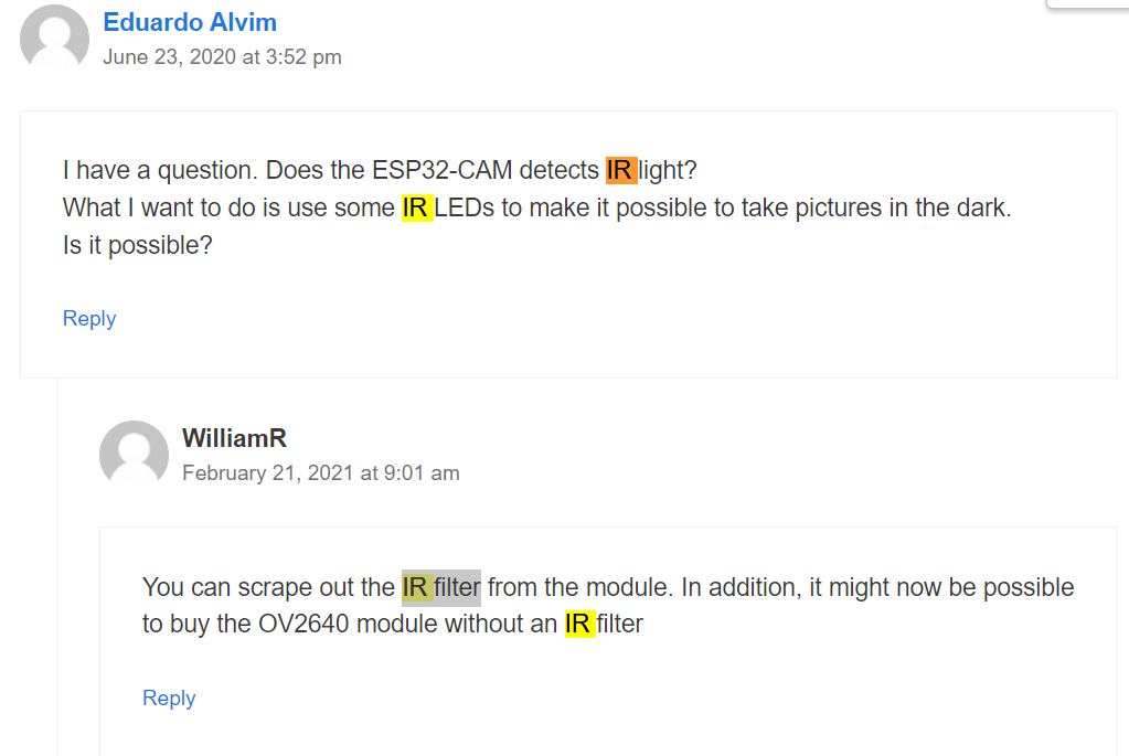

I also saw from a forum that it is possible to take of the IR filter of a certain camera module and then it should also work in dark? Is that true? If yes, how is the quality of the image? If bad, can it be resolved by including something?
