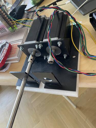

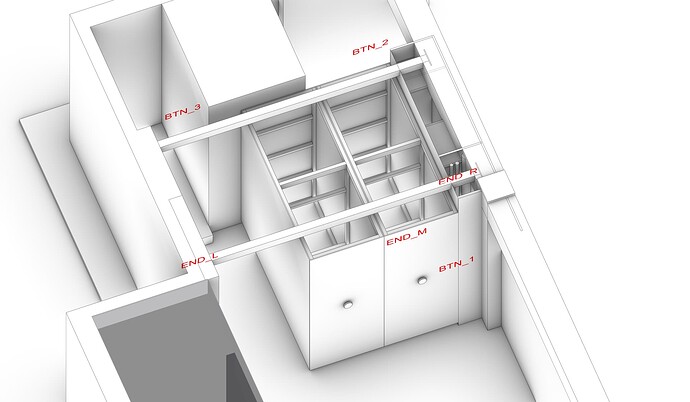

Hi folks,
I'm trying to motorise a wardrobe setup and have prepared the hardware part, but now I'm somewhat stuck on the programming task. I'm an architect, so programming is something new to me, but I'm trying to understand it as much as possible and trying to learn and watch tons of videos.
I have this schematic of how I have everything connected. Right now I'm doing the test part and I'm working my way through simpler code to more complex one.
I managed to write code, that moves both motors while holding any of the buttons. If I release the button and hold it again, the direction is reversed. If the endstop is being touched, it stops both motors and starts moving in the opposite direction with a small delay (so I would be able to release the button and the "home" position). This was pretty ok and fun, but now I'm at the trickier part.
I'm adding the third moving endstop (it is moving with wardrobe 2) and I have to come up with some logic on how to move the wardrobes. My first intention was to move one wardrobe at a time (to not put that much load on the power supply). When I press the button it should start moving W1 or W2 based on the last direction (the direction changes with each button press). Then it hits one of the end stops (L or R) and then it should start moving the other wardrobe to the Middle endstop. If Middle and L/R are pressed it has to move to the non-activated endstop and after hitting it it stops or if I still hold the button it has to start moving the other wardrobe. If just L/R is activated, it should move the other wardrobe to the M stop.
There are a lot of other problems I guess, but I don't have any idea, how to handle this kind of logic/variable-based code.
Do you have some inspiration, that I could read/watch to find some solution for this?
Here is the code, that I managed to test with the motors and end stops.

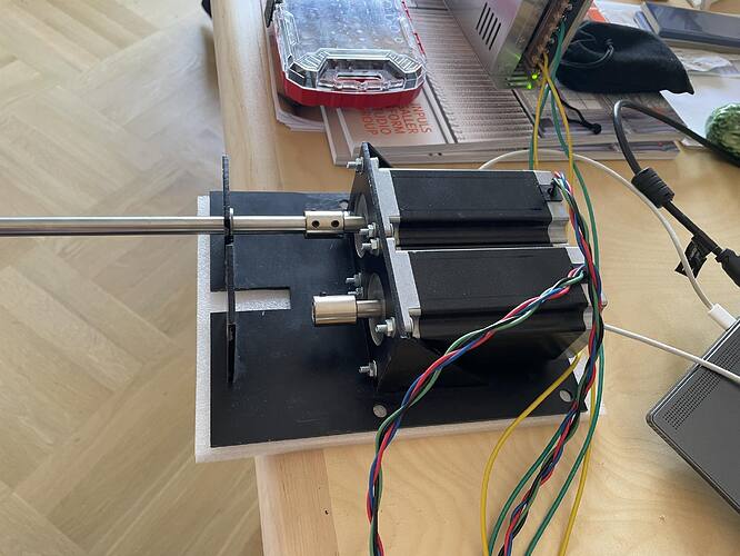

And pictures of the setup of the motor, some parts are missing, but I will add those once I install it in place.
Thank you for any advice or good word, I appreciate it. :pray:

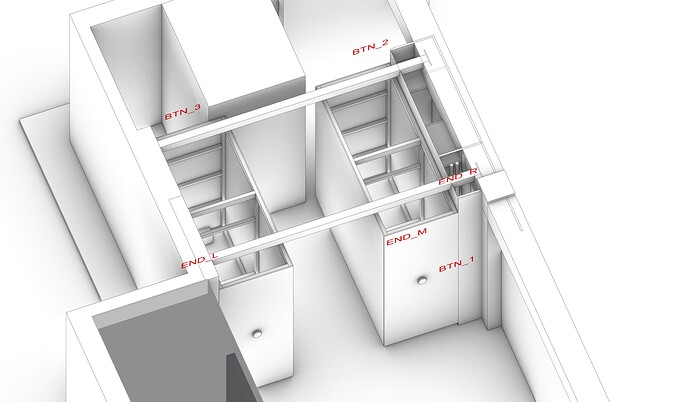

Draw a picture of the finished product, include button locations, limit-switch locations and try to convey how it physically moves. To me "wardrobe" is a free-standing box with doors, so I am not picturing three-dimension movement.
could you recognize that the button was pressed for < 1 sec and use that short presses to switch wardrobes
start the wardrobe moving or reversing (?) when pressed for > 1 sec

Here are the pictures of the 3D model. The text represents the approximate position of buttons and end-stops (the END_M will be attached to the left side of the wardrobe).
Im struggling with the logic behind moving one wardrobe/stepper and then the other, but I guess, that the movement is not that complicated.

Looking at your animation, instead of the #1 code, to see your intentions, I see behavior such that one could use with a state machine with these states:
enum MoveStates {IDLE_RIGHTWARDS, B_RIGHTWARDS, A_RIGHTWARDS, IDLE_LEFTWARDS, A_LEFTWARDS, B_LEFTWARDS} motionState =IDLE_RIGHTWARDS ;
...where at any one time, only one cabinet is moving one direction until it hits its endstop or the button is released and it then does the next thing. Something like this completely untested snippet:

There are three resting states, I would name them for where the gap is, Right, Middle and Left.
From a gap on the right and gap on the left, there is only one plausible movement, to move to having the gap in the middle.
Pressing when the wardrobes are in position left, middle or right would be unambiguous. If possible, move the wardrobe that can.
Pressing when the wardrobe is in motion could stop it, although besides keeping the cat from getting crushed I'm not sure why stopping in mid-transition is necessary.
Pressing again when the wardrobes aren't nicely parked R, M or L would move the unparked wardrobe in the direction left or right as pressed.
