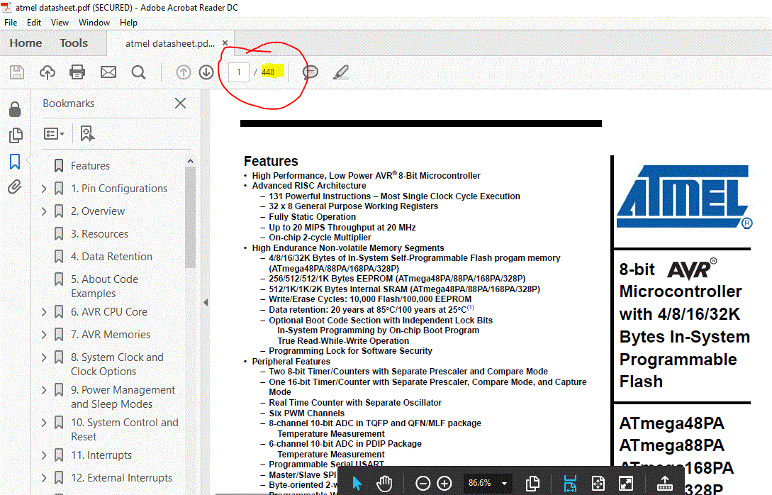

JohnRob:
So if you don't know or you aren't sure where to start, I would suggest you study the datasheet of one of the arduino processors
Yeah, right.
