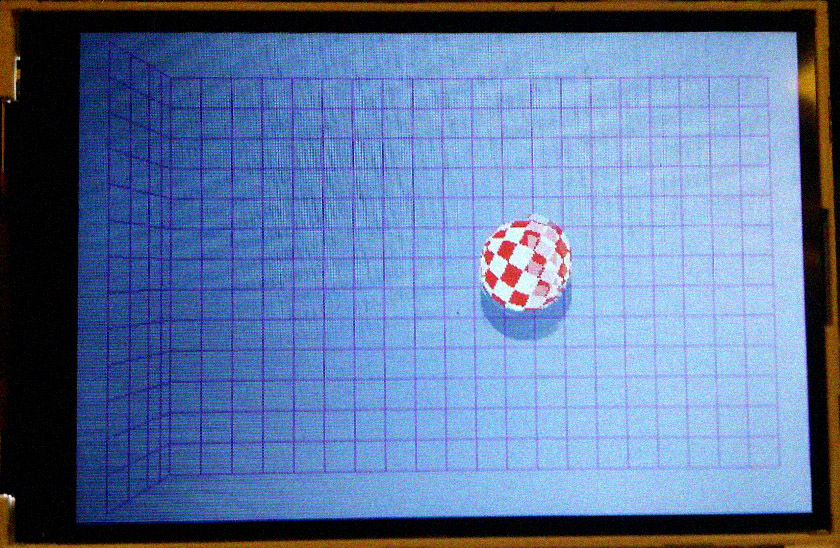

Hi David,
I am using these libraries with my display that reports "ILI8496" when you interrogate its ID:
#include <SPI.h> // f.k. for Arduino-1.5.2
#include <Adafruit_GFX.h> // hardware-specific library
#include <MCUFRIEND_kbv.h> // hardware-specific library
changed the dimensions into 480x320.
Further on in the sketch I note that ILI9341 is (maybe) forced upon this display - which it endures.
I need to review this sketch step by step and run it with other TFTs in my arsenal. So intimidating !
Here is a picture of the 3.5 inch 480x320 display. Hard to shoot, much interference with my phone camera. Applied a tiny dose of denoising in Photoshop to mask that.
regards, Photoncatcher
You just select the appropriate define e.g.
//#define USE_TFT_LIB 0xA9341 // e.g. Adafruit_ILI9341
#define USE_TFT_LIB 0x00000 // e.g. Parallel MCUFRIEND_kbv
MCUFRIEND_kbv will find the ID. Knows the dimensions are 320x480. i.e. PORTRAIT
You could edit the TFT_BEGIN() macro to set the rotation to LANDSCAPE.
From memory, it will draw the background correctly to match the geometry.
David.
