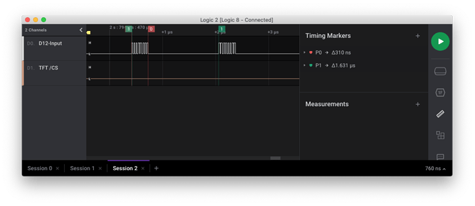

I wrote a lot of code using drawBitmap() to move a GFXCanvas to the screen. Performance was discouraging. I put a scope on the SPI clock and the TFT CS wire and saw the SPI clock moving at 24MHz, but discouraging lags between individual bytes. Each byte moved in 310ns, but the time per byte was over five times that. (See attachment)
I would have expected a memory-to-perhiperal DMA from a bitmap in memory to be moving many bytes edge-to-edge, at least the SPI FIFO size (16 bytes on SAMD21 SERCOM) for a wide-enough GFXCanvas.
I removed the #define of USE_SPI_DMA and saw no added slowdowns. I write a loop to do a fillScreen() 100 times and take the average, and that confirms no difference: 251.14 milliseconds per fill with or without the #define.
Should I see any difference, or is my experiment flawed? Is my subclass intializer causing this? Should a drawBitmap() of a canvas as wide as the TFT and 16 scan line high create a burst of DMA-speed SPI traffic? Am I using the wrong #define (is it a good test case)?
Thank you for your interest in my questions.
Quick reply to myself :slight_smile: and to benefit others, in future.
Summary:
  • A single #define was never going to work - not in plain C, and not in the Arduino sketch world.
  • Check your sketch's configuration.
I'm not well versed in how the Arduino builds are managed. There are pages here on the Arduino website that detail how Arduino sketches are built, and I've just started reading them. I'm more used to turning on a project-wide define in a makefile or build parameter file. So I was off-balance in trying that approach; it would never have worked.
One must add the #define to each DMA-dependent library's code, as well. Or to the sketch parameters, if possible. I want to think twice before just editing the libraries 'in place'. My initial approach might be clone the repositories for any library I'm going to edit and put my edits on a branch that I will never push back to Github. That way, I could continue to use the Library Manager to update those libraries as they come out - and trivially merge my local changes back in after an update.
Once I learn more about sketch builds, I can then decide whether or not I want to have the modified libraries be 'local' to each project - to allow the pure, unmodified libraries to remain the defaults for new projects.
As far as checking your sketch's configuration, I mean that after a quick scan of the libraries' code I see that I will need the sketch to provide ARDUINO_SAMD_ZERO as a preprocessor flag. The Board I have chosen for my project, which runs on the Arduino "ZERO PRO R3", is providing ARDUINO_SAM_ZERO and ARDUINO_ARCH_SAMD instead. I'll need to read the libraries more closely before I see if that's an issue - first glance says it will be - and decide how to address it, if so.
