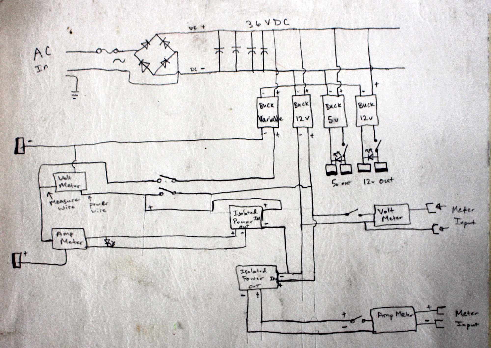

I've attached a video of my problem as well as a schematic
Basically, I have a mini amp meter that I want to measure the output of my power supply. It's built into the power supply and powered internally. After frying one circuit, I learned that these amp meters need to be powered from a source separate from what they are measuring. I now have an isolated power module to power the meter and then I'm running my output through the meter as well. Whenever I turn that output on, the amp meter reads around 6 amps. I haven't left it on for more than a second or two cuz I don't want to fry more things.
I gave more details and images in the video. Let me know if more info is needed or what ideas you have.
Thanks tons
Draw a schematic of how you connected it. I do not think many persons are interested in watching a video for several minutes without getting the information they need when spotting the problem in a schematic takes 30 seconds.
Alright, chances are you'll find more wrong with my amateur schematic than the actual circuit, but here it is. Sorry it's hand drawn. Hope it is clear enough.

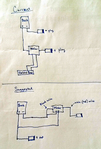

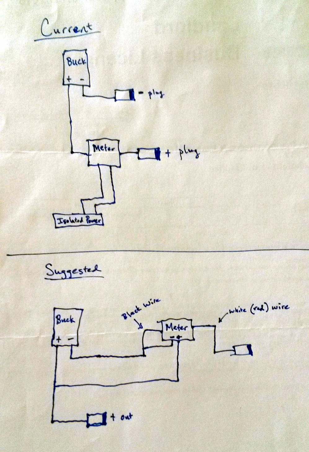

@raschemmel - I did test the amp meter before installation and it worked correctly. I also had it wired as it currently stands, only I powered it externally from a 9v battery and it worked fine. So I think the problem is definitely something with my current wiring (no pun intended).
@avr_fred - Now I'm starting to see what you're saying. Let me clarify to make sure. I drew a picture of how I have it vs. my understanding of what you are suggesting based on your reply. (ie. put the meter after the load rather than before?)
wire it like this? http://www.buyincoins.com/item/12315.html#.VHkNvDHF-Uk
Either way, am I fine to leave the meter powered through the isolator?
Raschemmel, the wires were in the eBay photos, no magic insight on my part.
Bradix14: The isolated power, no problem and since they are already wired in, I cannot think of a reason to change it.
Both drawings you posted are incorrect. :slightly_frowning_face:
The eBay drawing is easiest way to show the correct connection path. Just change "battery" to your variable output regulator module and connect the smaller red/black wires to your isolated supply which appears to be okay as-is since the ammeter powers up okay.

Alright, I hooked it all up according to the image. Still read around 6 amps with no load attached to my jacks. Then I disconnected both fat ampmeter wires. It still read the 6 amps!!! So my problem is something in between the isolated power module and the ampmeter...
any ideas or next steps.
thanks for the troubleshooting!

Hi, again, on your diagram you show LED's as output indicators, are these LEDs with built in current limit resistors, or have you fitted them but forgot to put them in your circuit.
Can I make a suggestion, reverse engineer what you have constructed, that is, start with a blank piece of paper and draw your circuit from what you physically have constructed, painstakingly trace every wire.
I know it can be a pain, I have to do it quite often, but I get payed to do it.
It will tell you what you have got compared to what you think you have.
When attempting projects like this it is usual to keep a circuit diagram as you design and assemble it.
It looks like it will be a nice bench electronics supply, but check your wiring.
Tom...... :slight_smile:
@raschemmel -- the amp meter is toast!! Thanks for making me take it out. Took it all the way out and it still reads 6 amps. The resistance is still almost 0, but obviously something is wrong. I'll have to order a replacement.
@TomGeorge - the hand drawn schematic is drawn as it is currently built. I just drew it yesterday for the purpose of receiving troubleshooting help. The LEDs do have resistors, I just didn't draw them in. Other than that, I traced every wire.
