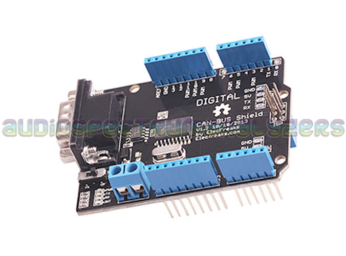

This is the EF02037 I ordered:

  1. Looking at the board in the above link the headers in the top corner don't cover pin 0 and pin 7, are these not needed?
  2. Does the EF02037 board run alone, sit on top of my regular UNO board or do I wire it to my UNO board?
    If it sits on top of my UNO board I guess the 2x4 connector needs to be soldered in upside down?

2) Does the EF02037 board run alone, sit on top of my regular UNO board or do I wire it to my UNO board?
That's how shields work, you plug them right on top of the Uno. By "2x4 connector" do you mean the 2x3 ICSP header?

Hi guys, finally have had the chance to play with the Arduino and the EF02037. I was using 8 data pins for the LCD and apparently they were conflicting with the pins used by the EF02037. So I have used 4 data pins and wired it as follows:
Arduino LCD
2 ------------------------D7
3 ------------------------D6
4 ------------------------D5
5 ------------------------D4
8 ------------------------ E
9 ------------------------ RS
When the 16 X 2 display is wired directly to the Arduino it works perfectly, however when I plug the EF02037 into the Arduino and wire the LCD through it, it just displays random stuff of the screen. I thought maybe there was a bad connection on the EF02037 board so have tested the continuity from the Arduino to a wire coming out of each pin (each pin listed above) and each has good continuity at 1.2 ohms.
Any thoughts as to what to test next would be much appreciated
