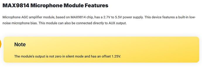

I searched for "arduino max9814" and this is the first hit that came up:
The comment in yellow outline explains what to expect:
1024*(1.25V/5V) = 256, so your ADC input is working as expected.

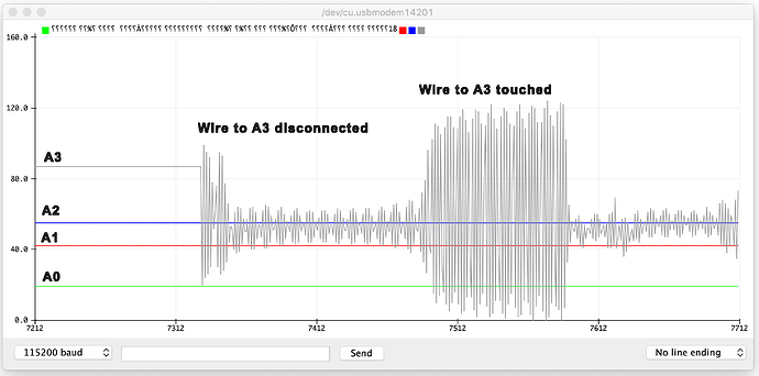

You should AC couple the sound signal to the analogue input, and then DC bias the signal to the mid point of the supply with a pull up and pull down resistor of about 100K.
Like this diagram.
This plot shows four analogue inputs being read in turn, with one pin unconnected, see how the residual charge on the sampling A/D capacitor follows the previous channel, and what happens when you touch the pin, thus injecting pick up noise.
