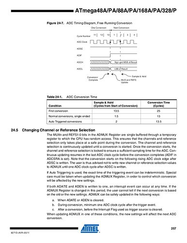

Hi all, I understand that the analogRead takes about 100 usec. I've been able to successfully use Jmknapp's method to get the reads much faster (closer to 20 usec). Thanks for that!
But I'm doing some fine tweaking on the program and was wondering if anybody knew off-hand whether the sample actually takes place near the beginning of the analogRead function, or closer to the end, or somewhere in the middle. I'm recording the time of the sample and wanted to know if I should record the time just before, or just after the analogRead statement to get the time closer to the actual moment the signal was sampled.

Before time stamp would be more accurate, as analogread "take a sample" first, and than function spending 120 usec trying to figure out value of it :)

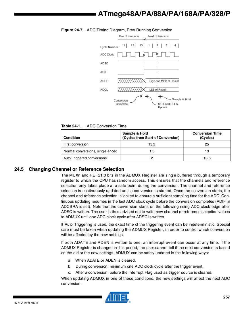

Not quite, you just describe how single-slope ADC works. Datasheet:
The ATmega328P features a 10-bit successive approximation ADC.
Successive approximation ADC take a sample fast and hold it, than uses DAC to measure voltage.
The ADC contains a Sample and Hold circuit which ensures that the input voltage to the ADC is held at a constant level during conversion
And there is a link: http://www.maxim-ic.com/app-notes/index.mvp/id/1041
The authorative answer is in the datasheet http://www.atmel.com/dyn/products/product_docs.asp?category_id=163&family_id=607&subfamily_id=760&part_id=4198 section “Analog-to-Digital Converter”. However it leaves the question how Arduino utilizes the ADC. This can be found out be looking into wiring_analog.c

Good point.
If analogread is calling to ADC with start conversion as “first conversion”, that probably the case with non-tweaked analogread, than I should correct myself, “sampling & hold” taking 54% of conversion time and value would be little bit closer to the end :~
In other two cases, “normal” and “auto-triggering” value is in the beginning.

Don't need to worry the digitalWrite will affect the output pin before it returns, setting a pin is one cpu instruction - the fast start up of the ADC is because the way it works is to multiplex the relevant pin to the sample/hold circuit, then sample and hold it - all within the first ADC clock or two. It takes at least 10 more clocks to do the successive approximation, one for each bit.
