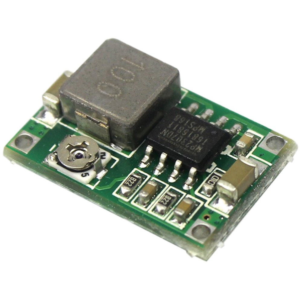

"Jremington"here is a buck converter I have. Where should I put it in the circuit?
