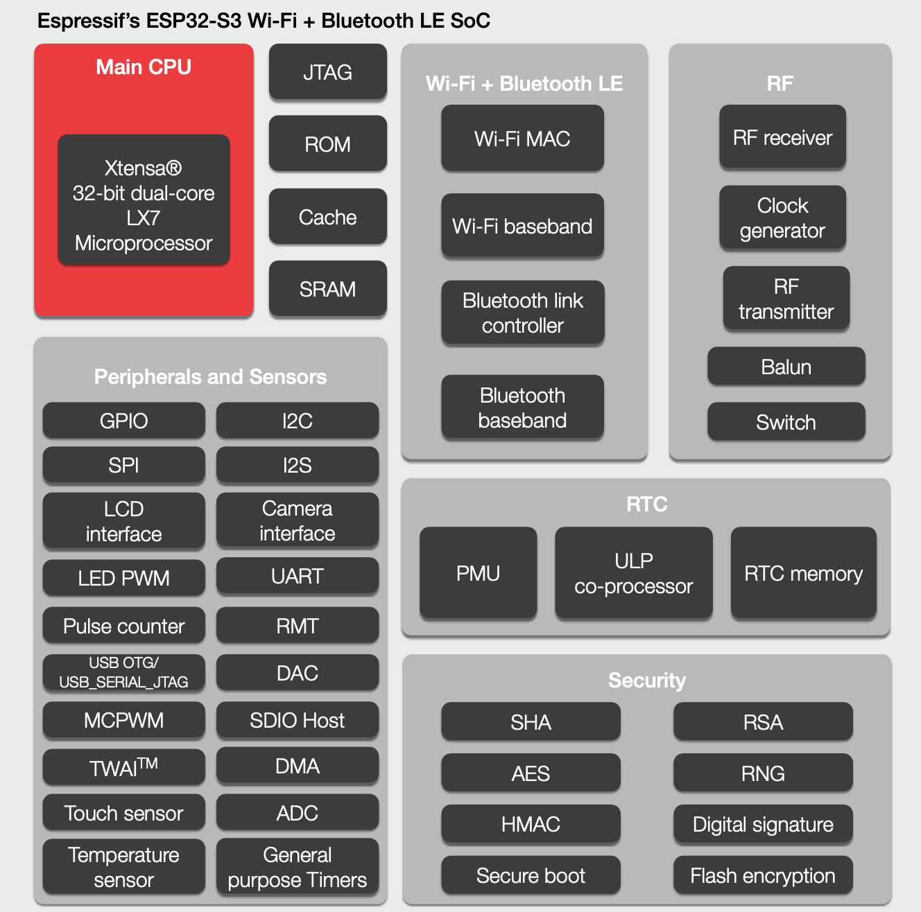

Responding to the ever growing significance of AI, we are delighted to announce the newest addition to Espressif’s series of MCUs, ESP32-S3, which has been specifically designed to address the needs of the AIoT market.
ESP32-S3 is a dual-core XTensa LX7 MCU, capable of running at 240 MHz. Apart from its 512 KB of internal SRAM, it also comes with integrated 2.4 GHz, 802.11 b/g/n Wi-Fi and Bluetooth-Low-Energy 5.0 connectivity that provides long-range support. It has 44 programmable GPIOs and supports a rich set of peripherals. Compared with ESP32, it supports larger, high-speed octal SPI flash, and PSRAM with configurable data and instruction cache.
À noter
AI Acceleration Support
ESP32-S3 has additional support for vector instructions in the MCU, which provides acceleration for neural network computing and signal processing workloads. The software libraries for the above-mentioned optimized functions will become available very soon, in the form of updates to ESP-WHO and ESP-Skainet
