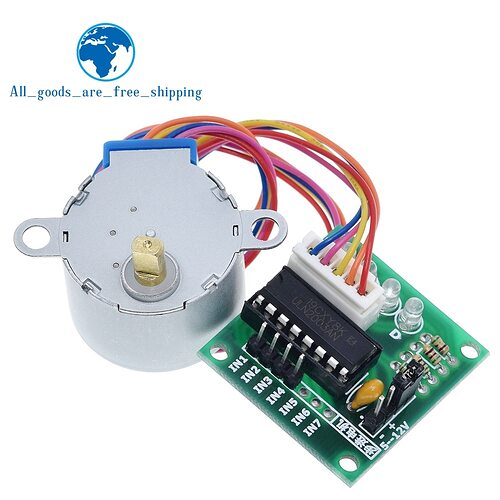

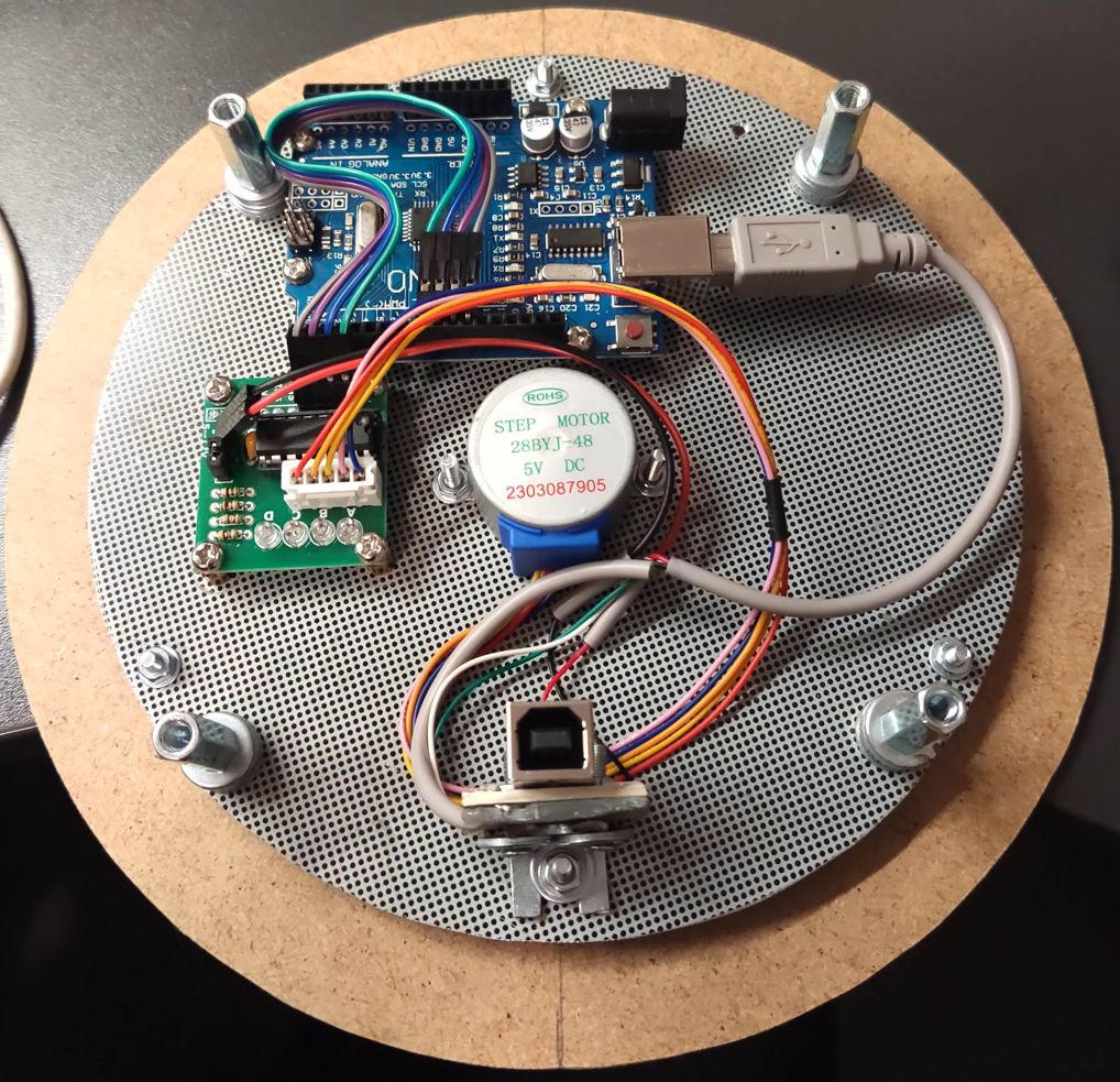

Arduino Uno, a stepper motor + ULN2003 board (more in the pictures)

so can you provide links to the components - eg "stepper motor"
strange calling an output "in1"
this part of the code works and I was able to set it to rotate one rotation each hour for testing
just changing the delay would result in sending 5V to the stepper motor for 24h a day, which is not neccesary.
Sure;

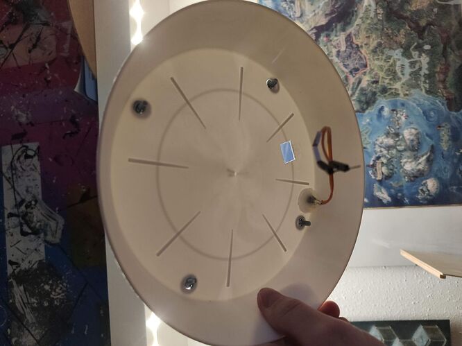

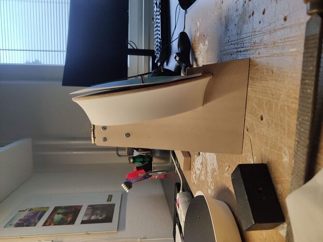

Sorry, i forgot to upload the images;
And yes, weird, i copied this par from net and didnt bother changing that since

Just thinking aloud: when you turn off the motor power, Did you check that the remaining torque is high enough to hold the needle in place? In one of your picture the clock is almost horizontal so the weight is probably negligible but what if the clock was vertical?
