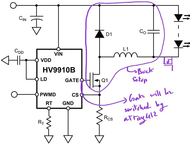

Guys I found this led driver HV9910B.
would this thing be as unsafe as my original plan, like if I don't use an isolation transformer. But if I use a isolation transformer at the main hub and distribute it from there, wouldn't it be more safe.

The circuit you show is not usable with 24V LED strips.
The high current problem is usually solved by having more than one power source for you lighting.
If you use 48V then you only need 10A and if you split the lighting into two groups, then you only need two 5A supplies.

HV9910 IS NOT usable with 24V LED strips

The HV9910 Is not usable with 24V LED strips.

See #17. I am not talking about using HV9910B. I am talking about using a microcontroller to drive the gate to produce 24vdc.
