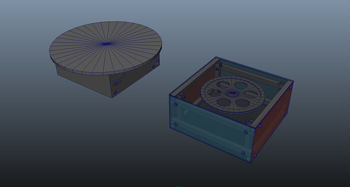

Another motorized Lazy Susan, but with some flavor. Please Help !
Hi there and thanks for your advice !
Project Outlines:
  • motorized Lazy Susan ( yes, I know, it's been done a thousand times )
  • it is for object VR photography ( rotate a product on the table while taking photos of it )
  • realistically I need it to work with loads up to 10kg on a platform that should fit a normal kitchen chair
  • the ambitious version should work with loads as large as 100kg ( a person's average weight ? )
  • I want it to be autonomous - no connection to computer required while operating
  • should have a display ( 2 lines x 16 chars should be enough ) for routine presets or custom cycles, and buttons to input these
  • for custom settings I want to be able to set number of photos or degree intervals, pauses between shots
  • I need it to trigger the camera ( just closing a circuit )
  • maybe a buzzer also for marking the progress, cycle start, cycle ending, feed back on pushing those little buttons
Why don't I want to do it manually ? Because I am a lazy ass, because 36 flashes even with my eyes closed is too much for me. And when you have 10 things to shoot is even worse. Then, something breaks your attention, and you have no idea if you shot position 13 or not. Or if all the flashes went off, because you went at it too soon, and the strobes didn't load fully. So, you see, when one does it manually, there is a thing called human error that ruins it all. Besides this, I love DIY projects.
Questions:
  1. What Arduino board should I use ?
    Can I control the stepper motor shield and the display and the camera triggering and the beeper with one Arduino board ? Do i need the Mega 2560 ?
  2. How powerful does the stepper motor needs to be ? I plan using a small timing pulley on the engine and a rather large wheel inside the "box" to drive the table on top, connected to the motor by a some belt. It will be in the range of 300mm diameter for the big wheel and 25mm on the engine cog. The external platform will be 400 to 600 mm diameter.
  3. If I need to use a motor that requires more amps than the Arduino can provide, how do I power the engine from external source ? I couldn't figure this so far. If you would like to give an answer .. this is where I am most confused.
  4. Do I really need a bread board ? Don't like those wires running in all directions. Don't pick on me on this please, excuse my ignorance.
  5. What do you recommend for a power supply ? Can I use a computer power supply ?

So far I am working on a 3D model of the contraption (mechanical part), once I get it to the right proportions and scale I will post some scr caps.

I would make the gearing ratio as large as possible, I'm thinking ~12mm drive or smaller and a driven pulley the same size as the plinth (400-600mm or whatever). In fact the driven pulley should actually be the plinth with a grove cut around the edge.
As for the display, one of the guys here has some LCD displays with menus etc.
Rob
Thanks graynomad.
I am also considering to buy a geared stepper motor. They seem to have a big ratio and I don't need speed, I need power.
For the mechanics I was thinking of using a bicycle axle, to which I will mount the platform and the pulley. There are for sure some things that need to be sorted out.
Bicycle axles are designed to take force at right angles to the bearings, I think you need a thrust bearing or a proper lazy susan bearing. Both are designed to isolate two parallel planes which is what you are doing. Over here are least you can get the LS bearings in any hardware store, although I've never looked at one closely to see the quality.
A thrust bearing from a car would work as well.
In all cases though the platform will be much larger than the bearing so if the object is not well placed things could get a little wobbly. Once again a lazy susan bearing is better because they are very large, maybe 10 or 12". My chair is sitting on one as I type.
Are you using the motor at the centre of the turntable? If so you have no mechanical advantage but if the gearing is high maybe that's OK.

Re the bearings, I think you said the load could be 100kgs before, a trailer stub axle will work well for that sort of load, same as a bicycle axle in relation to the load direction to the bearing but they are designed for 1 tonne or thereabouts and have tapered bearing so you can torque them down to remove any play.
They are cheap as well IIRC, although I haven't bought one for a few years.
Rob
I used to work on industrial CAT scanners, and they typically used metalworking lathes geared right down to rotate the workpiece.
Mounting vertically might be tricky.

Thanks Rob, will consider the options you suggested. But now the mechanics part seems light years away.
The plan was to have a high gear ratio between the motor axle / cog and a large pulley inside the "box" - housing of the whole contraption. Yes indeed, 500 mA should be more than enough for now at least.

I have the 6" lazy susan bearings rated to take 500 lb load, that's over 200 Kg.
Here's the 12" which the wider the circle the more stable and easy to turn your even wider load will be:
These beat H out of trying to mess with much heavier or otherwise unsuited stuff. If you put your load on top then a -small- wheel out at the edge in contact with the table top or floor the rig is sitting on will be able to turn the whole thing in a very slow and controlled manner without using enormous power or needing much in the way of transmission.
Think of a small kid pushing a playground merry-go-round massing many times what the kid does.
http://www.google.com/imgres?imgurl=http://image.shutterstock.com/display_pic_with_logo/153391/153391,1212514930,5/stock-photo-a-playground-merry-go-round-in-the-grass-13344022.jpg&imgrefurl=http://www.shutterstock.com/pic-13344022/stock-photo-a-playground-merry-go-round-in-the-grass.html&h=322&w=450&sz=81&tbnid=1A74Gd779g0F4M:&tbnh=90&tbnw=126&zoom=1&docid=GoiXUd8LHBNPwM&hl=en&sa=X&ei=DymoTrqBAoHg0QHMnaC7Dg&sqi=2&ved=0CGcQ9QEwBA&dur=8000
You still need at least one motor driver. If you need it to be able to stop quickly then work on brakes that make direct contact with the surface below the unit (like feet stuck down and dragging to stop the merry-go-round/carousel) and leave the poor drive motor and wheel out of it!
Another thing to illustrate is go find a heavy motorized potter's wheel and look at that. There is the wheel on top and shaft below to another wheel at the base. The potter may kick the base wheel around or press a foot switch that brings an electric motor with small wheel turning on the shaft down against the outside rim of the big base wheel. 1/4 horse motor turns the concrete-filled steel wheel nicely. You won't need anything like that much power!
A small diameter wheel turning against the rim of a large diameter wheel has great mechanical advantage. Wheels are levers after all, a 50-lb kid can lift a car with a long enough lever. Just not quickly!
The complicated parts are more likely what the load on top is doing and how it knows where it's pointing.
I could be wrong but I think a "pottery whirler" would be ideal for your application - do a search for them.
They will usually rotate on a stainless steel bearing or ball race, all you would need to do would be attach your pulley to the shaft.
The top will normally have concentric circles etched on them allowing you to position your object centrally easily.

Please have a look at the 3 images attached for really WIP, basic mechanical plan.

Have a look at the Scr shots for mechanical WIP sketches but again, mechanical part seems to be light years away.

Pic #3 is the same as #1.

The missing pic also was attached. The motor will be in one of the corners.

You should look at a set of the Lazy Susan bearings because they are 4x stronger than you need, work very well and cost less than $15. They are also quite thin, less than 2cm thick, and do not have any axle so the load is spread wide over many ball bearings which is why the LS has such high weight capacity yet weighs very little.
You go with a pottery wheel and you add the considerable weight of the pottery wheel to what your motor and brakes must handle. Pottery wheel is made heavy to keep turning constant while the potter shapes the clay above. I have 9 credits in ceramics most of my art electives, I know the wheel quite well. A good one is heavier than the potter using it.
The Lazy Susan bearings are functionally two square plates with bearings between and a big hole through the center. The plates have small holes at the corners to mount with. Bolt or screw a base plate to the bottom and your project on top. You can hide drive and brakes inside that if you need. Just a small motor with small wheel on the shaft mounted to the upper part with wheel edge in contact with the base plate below. But the smart thing would be to drive out at the edge.
And here is a question. Do you need to turn the whole mass or just a camera? Does it need to turn around and around or will one 360 or less turn do? You may want to do like R2D2 and only turn the top.
Hope I don't have to install a break. I will keep my loads small, and if I really need huge loads I guess I will implement that too. Maybe with a solenoid with a breaking pad. What a circus it will be !
If you are using a stepper motor for this you definitely should not need a brake. If you do you have done something wrong either you are just accelerating/decelerating too hard, or your gearing is wrong or the motor is underpowered.
