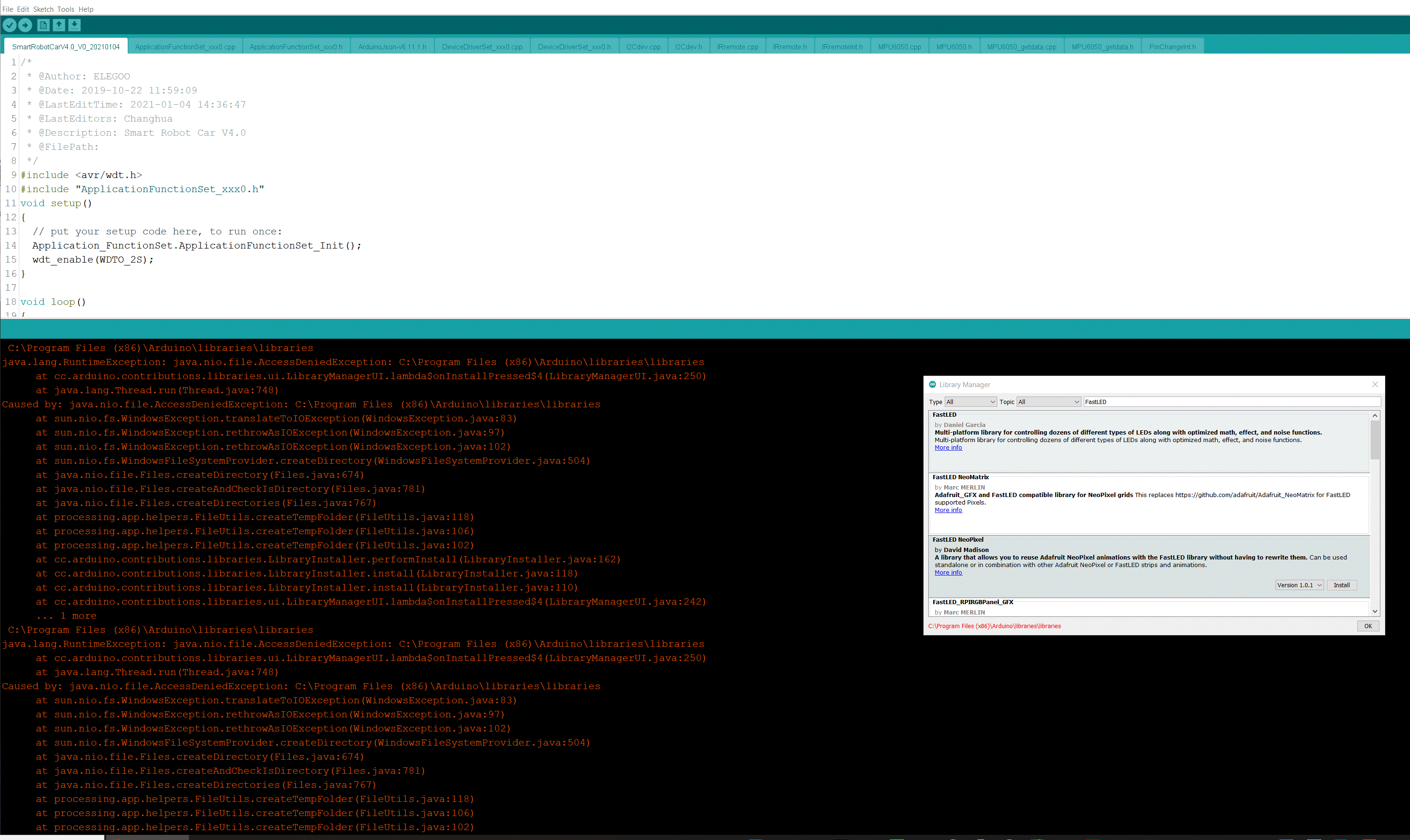

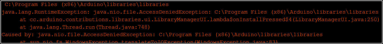

This is the sole problem:
This is not a valid location for the sketchbook. Windows has strict security controls on the C:\Program Files (x86)\ folder, which is what caused this "AccessDeniedException" error when you tried to install libraries to a path under it:

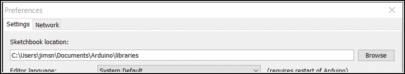

This is not technically wrong, but having the libraries in the path will end up causing you and the people trying to help you confusion.
The sketchbook is a folder for storing sketches and libraries. The libraries are automatically installed to the libraries subfolder under the sketchbook location. So with this setting your sketches would be here:
C:\Users\jimsn\Documents\Arduino\libraries
and your libraries would be here:
C:\Users\jimsn\Documents\Arduino\libraries\libraries
Do you see how that can be very confusing?
So please change the location again to something that won't cause confusion.

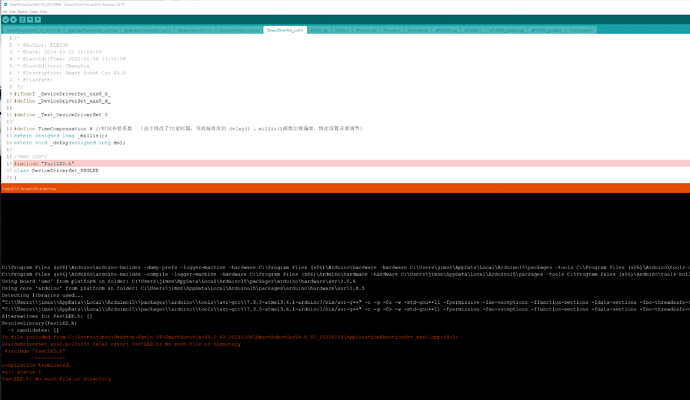

That's it.. I still have the "No Such File" issue .. it can't find the FastLED.h
Still the same problem.

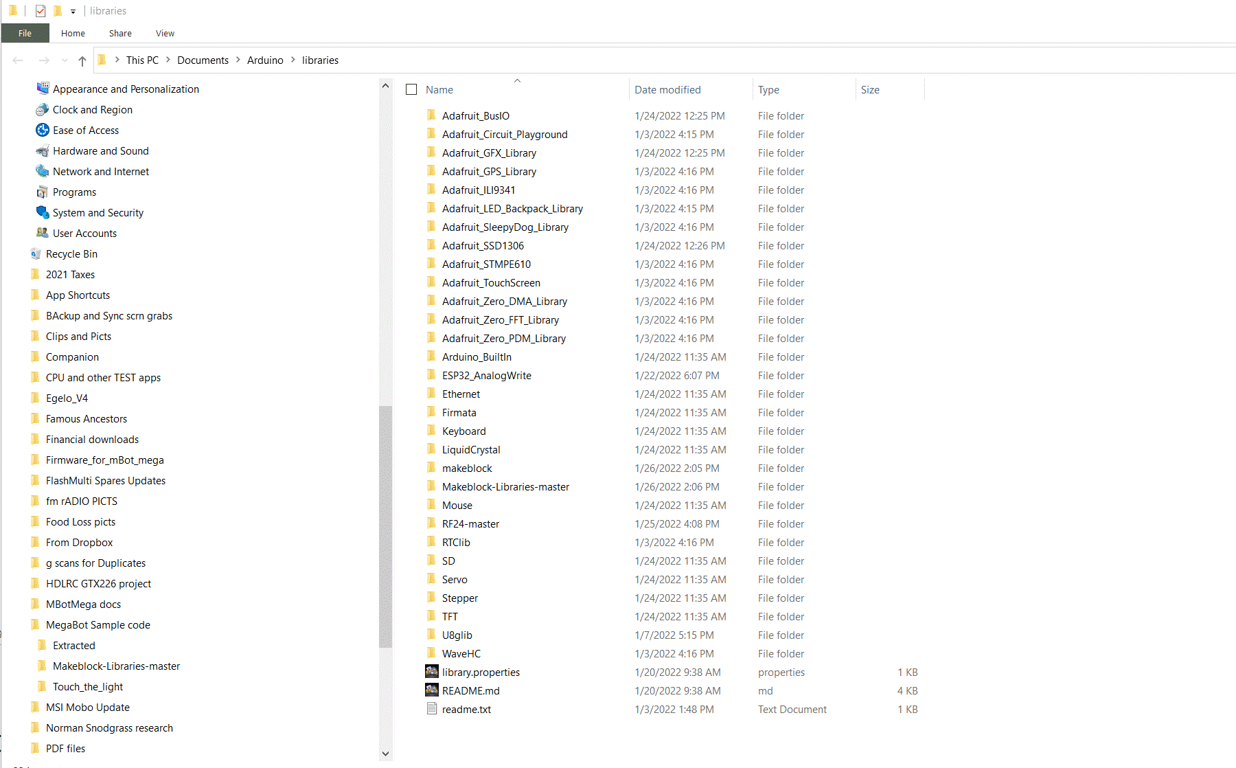

Just as in fyi, and a recap, this is what was in that (x86) library several days ago when I 1st encountered the issues with various differrnt pre-compiler not found errors.. I deleted these 4 lib folders since) per the mrf's guidance) I had MANUALLY copy/pasted these /zip files in there and was told this technique is a NO-NO on another site's forum so I deleted them but now I can not re-add them using the Add-Zip option since that process and option says they already exist.. Bear in mind AddZip worked perfectly fine and I can compile this big V4 system's .ino just fine on another machine .. my laptop. As to the (x86) Arduino /library/library folder I don't see it.. in any case that entire (x86) Arduino /library is now gone.
