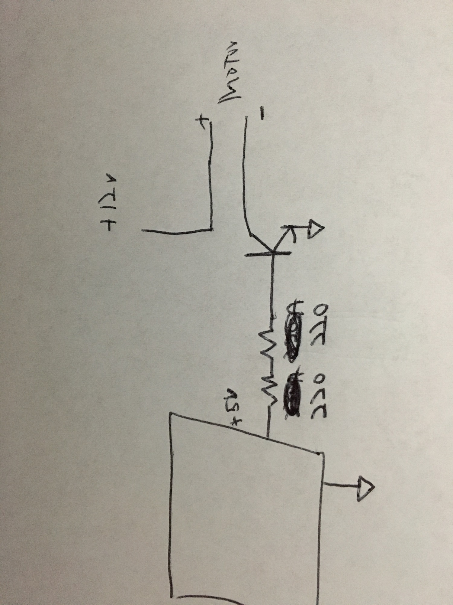

Thats a great idea. +12v to motor pos
collector to motor neg
+5v from arduino--------------220 ohm resister-------220 ohm resister------!<
emitter to ground
-5v ground
Hope this help and you can follow i could not attached anything.
robkiller:
...because the 12v always flows weather the 5v is added or not.
Maybe you have connected the transistor wrong.
Or you have already killed the transistor, because I don't see a kickback diode in your diagram.
Post a real picture of the setup.
Leo..

Sorry my last post was no good trying to explain what i did. This should be a little better.
Where is the back EMF diode?
Leo..
Posting image:
Maybe not having the diode is my issue lol Where would that go?
The diode (e.g. 1N4004) goes across the motor.
Cathode (ring) to +12volt, and anode to the collector.
The diode kills back-emf from a motor/solenoid when the transistor turns off.
The spike (without diode) could be hundreds of volts and could kill the transistor.
I assume you have connected 12volt negative to the emitter.
And Arduino ground also to the emitter.
Leo..
