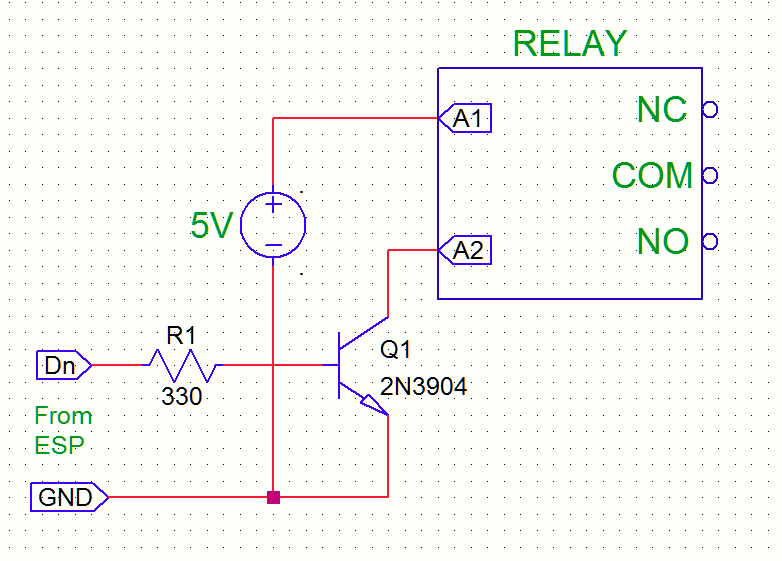

This is what you need to do

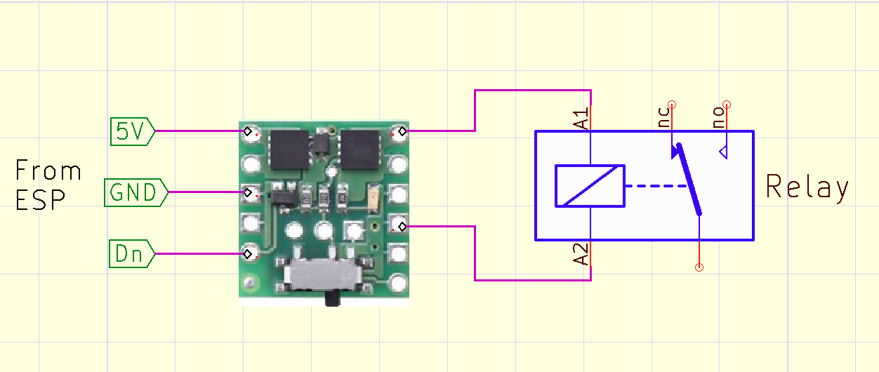

I tried to document the current setup. I apologize in advance for any readability issues or wrong symbols.
Is it available as a ready-made thingie like the logic level shifter? I will need two channels once it is working.
Yes but I have to draw a new schematic
On your wiring scheme you have also wrong polarity for that relay coil.
Depending on the ESP board, you may be able to connect the 5V to the ESP 5V, otherwise you need a separate 5V supply
Yeah, sorry. Drawing error. Actually they were right.
Great, thank you very much!

As indicated previously the logic level shifter are not for powering relay coil, and the wiring of coil is wrong, be careful with such wiring errors, the microcontroller is at high risk of being damaged. Using a switching transistor MOSFET well enslaved is a good solution for this type of setup, the use of an optocoupler could also do the trick very well to order this relay.
